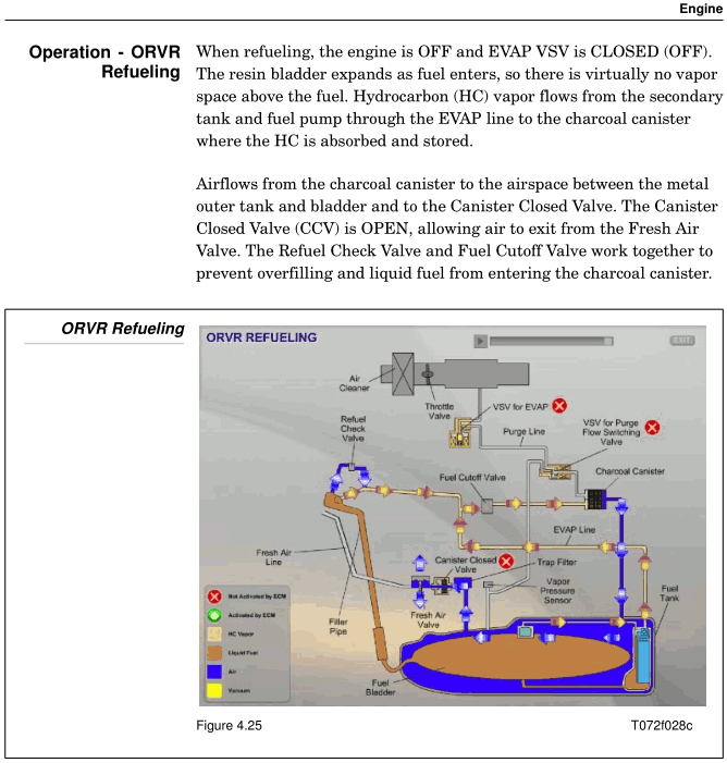

    As far as I know, it was all about getting the Prius CARB SULEV (or some such acronym) rating. It's always about the emissions.
  11. ChapmanF
    28,721
    19,020
    It's a darned effective system for eliminating the gasoline vapor release into the atmosphere when you fill the tank.
    In an old-skool fuel tank, by the time you roll into the filling station because you're out of gas, you've got a tank with ten gallons of gasoline vapor in it. When you stick the nozzle in that tank and add ten gallons of liquid fuel, you are forcing those ten gallons of vapor out of the tank and right into the atmosphere. Multiplied by the number of vehicles filling up at the number of filling stations everywhere.
    In the bladder tank, the fuel is never anywhere but in the bladder. There's no space for vapor as the fuel is used up—the bladder just shrinks around it. The space in the tank outside the bladder is filled with fresh air. When you fill the tank, the bladder expands, and what gets forced out into the air is nothing but the fresh air around the bladder.
    There is still an ORVR/EVAP system with a charcoal canister and plumbing to mop up what little vapor emission is left over. But by the time of Gen 3, that kind of system had matured enough to meet the same emission targets without the bladder, so Gen 3 just has no bladder and the more complicated EVAP system (which even includes its own little electric pump and does workouts overnight five hours or so after you park).
    There is still ORVR plumbing in the earlier, bladder-tank systems, and if ChuggyPyg is burping fuel on you when filling, it's likely to indicate a problem that can be fixed, and not just the fact of having a bladder tank. (How long have you been driving ChuggyPyg without getting pints of fuel on your feet? The bladder's been there the whole time.)
    Some information on getting the ORVR system back up to snuff can be found in this thread.

    I hope @WilDavis won't miss the point that if the car has had a bladder fuel tank for a dozen years but just burped fuel out this week, that's probably not so much because it has a bladder fuel tank, and more because an issue in the ORVR system has probably developed and can be fixed.

    That's definitely not recommended. Overfilling is likely to get fuel into the components that are meant to handle vapor during onboard refueling, and then causes this exact problem. The thread linked to in #11 can be followed for more information on how the problem can be fixed.
    As an example you might not want to follow, the thread involved an owner who had been habitually overfilling, started the thread, spent the money to get the damage repaired, went right back to the same overfilling habits, and started another thread for the same issue less than a year later.
