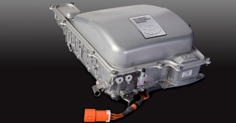

    TB3 is a well known term for me, and I really wondered if it would mean the same in this setting. :D
    Yes it does.
    Where is the inverter? Is it under the hood? Can't find it in the linked pic.
    I also considered it might be the black-box next to the battery, but that doesn't look sturdy enough.

    Big silver 'cover' on right side of t[​IMG]he engine compartment.

    So the 200V->12V converter is in the same box as the 200V-650V converter?
