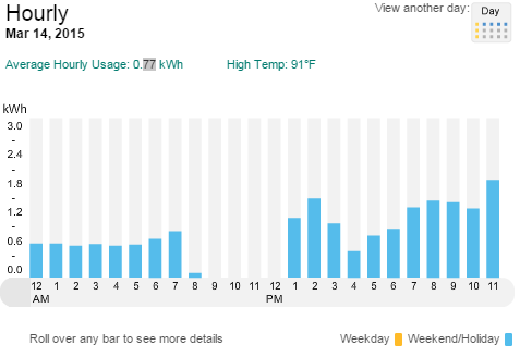

    Hill, I take it you're on SCE and not SDGE; if so, when you go to SCE.com and look at prior day's consumption by hour, are you seeing negative consumption on that daily graph?
    For us, here's what it looks like for yesterday. I'm assuming those zero hours are generating a lot of power we're currently not credited with (and won't be till the PTO is issued). Capture.PNG
