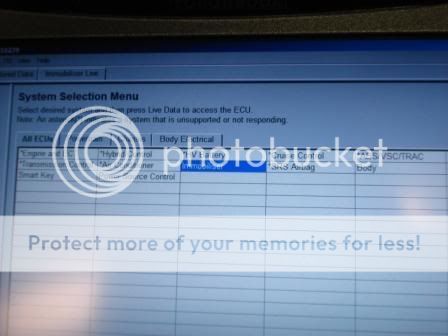

    anyway, DH just took a few pics of the procedure as done on the new scantool/laptop deal.
    first: connecting to the car without keys.
    description of immobilizer reset:
    you see this description when you select this:
    after selecting that option, you see this screen
    and connect to car, with blank fob in slot and car off (because without keys... it won't turn on!)
    it takes quite a while with the car off.
    you have to enter car info manually
    and after this screen, it gives you the seed number to reset the immobilizer.
    next, the TIS authorization. not just anyone can log in and do this.
    it's under the diagnostics tab, listed as "immobilizer reset"
    and after this screen is where you enter the seed number you get from the car.
    this should be enough to get ANYONE started. now if someone still has trouble getting their local dealership to do this... well, there's only so much that we can do...
