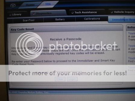

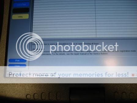

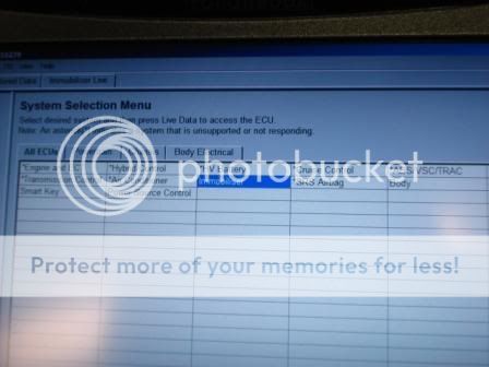

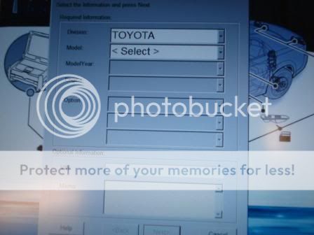

    The pictures don't seem to pop up I'm wondering if you can message me the pics or walk me through it. I have everything needed and I'm pretty tech savy with this prius. I just need help locating the seed number feature on my techstream. Thanks in advance

    I'm pretty sure you still won't have access to it. I believe you have to have the Security Professional TIS subscription to enable that feature. They don't want just anyone being able to re-program car keys for obvious reasons.

    17,715
    10,452
    She hasn't logged in here in nearly 4 years, so won't see your query. And the pictures were probably detached in one of PriusChat's numerous host and platform migrations since that item was posted more than 13 years ago. So someone else familiar with it will have to help.
    And as I read it, it still had to be done at and by a dealership. Her hubby took those pics as they walked the dealer's tech through the process. You probably can't get the same secured Toyota access at home.
