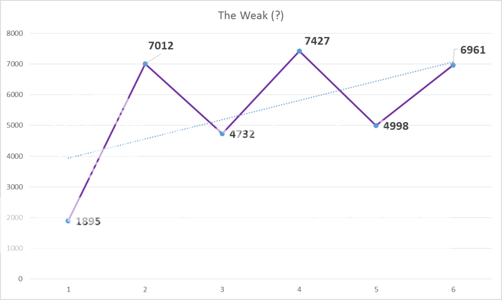

    This one showed a static V reading of 7.61V but after balancing process showed the below characteristics:
    Question 3: Is he The Weak and I better replace him. I notice also at the 2nd and 3rd discharge that they differ only 26.6mAh plus a low final charge of 6961 mAh.

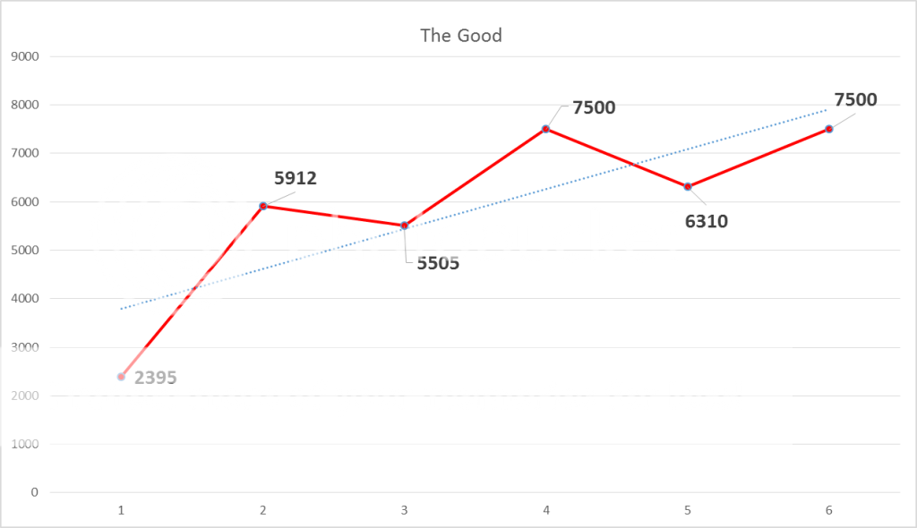

    Below chart is definitely “The Good”.

    Thanks for those graphs. Are those voltages that you observe, in the list of modules, taken from your reman battery? If so, that is not a good sign. Maybe they were from the original battery.
    After cycling the low 6.2V module, what is the resting voltage now? Did it change? If not, then maybe a few more cycles might shift it a bit? This is an experimental field, so all the data points help.
    I think the main thing I have seen from the DIY balancing posts, is that if there is much divergence in a given module characteristic from the norm, it is best to replace. It will probably need replacement down the road, sooner rather than later.
    The one thing that is not being well measured in these balancing cycles is the internal resistance of the module at high current. One way to do that is installed in the car, using the mini VCI. Otherwise, one needs more specialized instrumentation.
    It is the internal resistance that makes for excessive heat in a pack, which is a detriment to adjacent modules. It is possible for a cell to have decent capacity, but a borderline high internal resistance.

    So, the module that was at 6.2V is bad, replace it. A voltage reading of 1.0 to 1.5V lower than all others is pretty much diagnostic of a failed cell. It will likely drop out when heavily loaded.
    The others could be fine after discharge - charge cycling. Some people just go with what they have based on the discharge capacity. Others will load test the modules with 5, 10, or more amps.
    What they do is to record the module voltage then apply a bigger load (say one or two 12V halogen headlight bulbs) for a fixed time (maybe 30 seconds) and note the voltage just before turning off the load. They look for similar drop.
