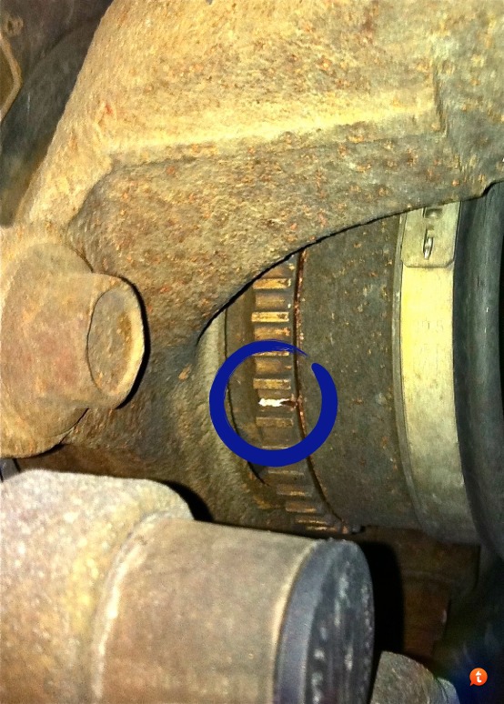

    Also when they reassembled they may not have seated the dust shield correctly. There is a hole in it and it needs to line up with the hole for the speed sensor so it can properly detect the ABS exciter ring. It could very easily just be a little debris on the sensor tip though. When I swapped out my wheel bearing hubs one small fleck of metal stuck to the tip and triggered all my vsc abs lights as well. If you take it out and it's definitely clean try to safely look inside the hole to see if you can see the exciter ring. Also inspect the exciter ring as if it was damaged it too could cause your issues. Might as well check those before throwing money at a new sensor (it's really not that delicate of a thing). The picture is of a generic exciter ring so you know what to look for. All those teeth are detected by the sensor as the wheel spins so a single chipped tooth could confuse the system. [​IMG]

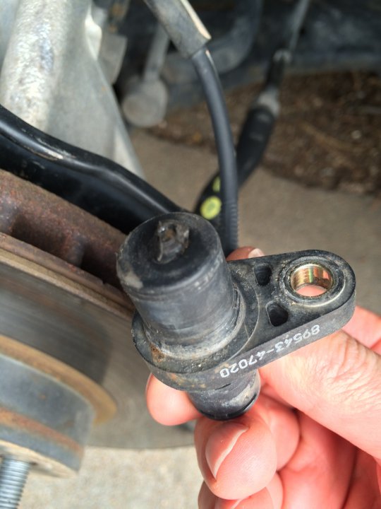

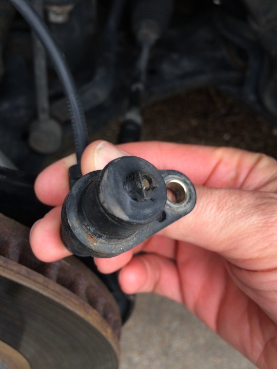

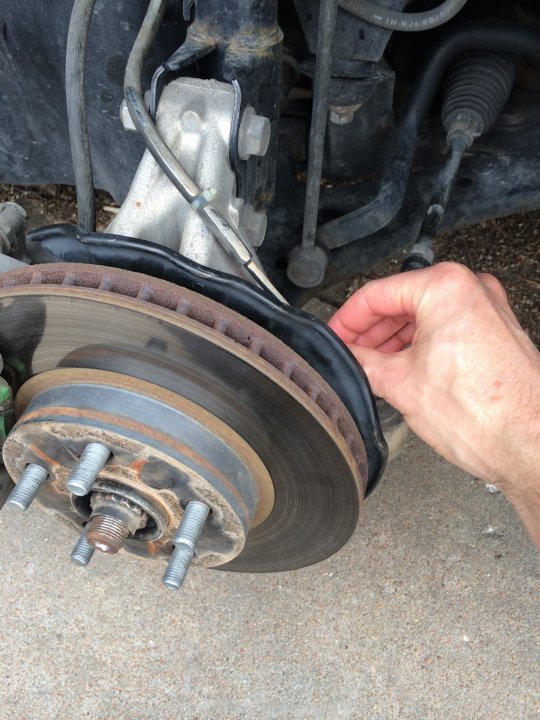

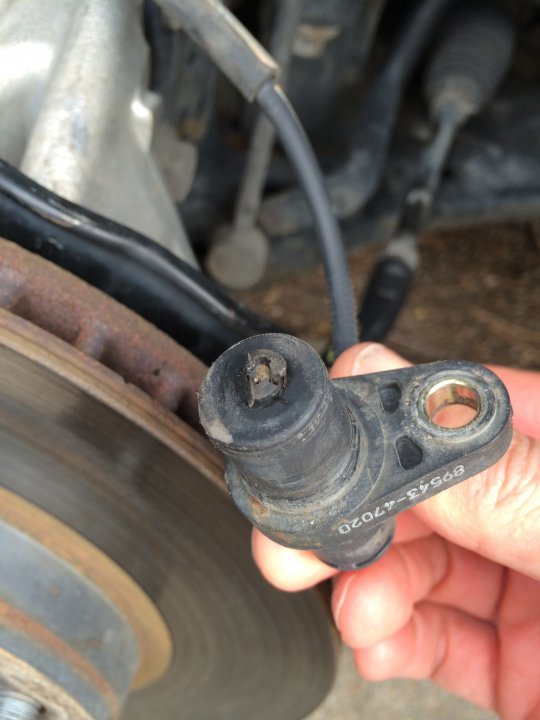

    Thanks Patrick. I snapped photos of what I think is the sensor.
    If that's it, it certainly looks munged up to me. If I'm understanding the pic you sent along with what I see when I look at where the sensor seats, I can imagine how a piece of debris (or if it were possible to attach the sensor too close to the exciter ring, the ring itself) could tear up the tip of the sensor. Is this pretty clear visual evidence that the sensor is damaged and needs replacement?

    That's the sensor and yes it's definitely damaged.. It can't physically get too close to the ring; fully seated it will sit a small distance away. Either something was stuck to it when they put it back in or it was damaged when they had it out. If you don't think they'll replace it for free you might as well clean it up as best as possible and see if you can't center that post a little bit.. It might work while you wait for a replacement. Definitely check the ring for damaged teeth as well at this point.

    Probably. I suggest you compare to the sensor on the RF wheel to be sure.
