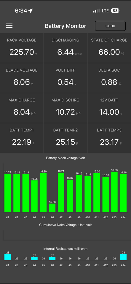

    Latest update: plugged in the dongle from the Dr. P site.
    I'm now getting realistic data.

  14. Brian1954
    Brian1954 Senior Member
    Jan 31, 2021
    2,694
    1,077
    South Central PA, USA
    There is a problem with one of the two modules that makes up block #6. That is the reason why the voltage of block #6 is lower than the others.

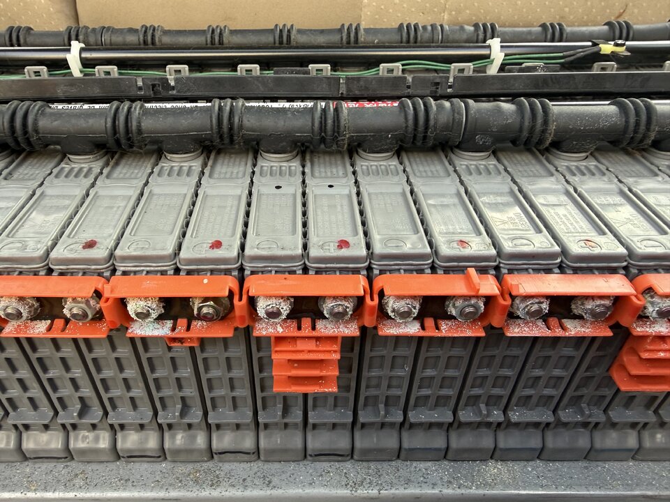

    Latest update:
    After popping the battery cover, I discovered plenty of corrosion. My new harness annd hardware arrived today, so I’m going to be installing that when the weather warms up next week.
  19. Brian1954
    Jan 31, 2021
    2,694
    1,077
    Why do you think the wiring harness and hardware needs to be replaced?
    Based on the Dr Prius screenshot in post #13, you have a bad module in battery block #6 that needs to be replaced. Read post #14.
    Replacing the wiring harness will not fix the problem with the bad battery module.

    Looks like the battery's been messed with already possibly
