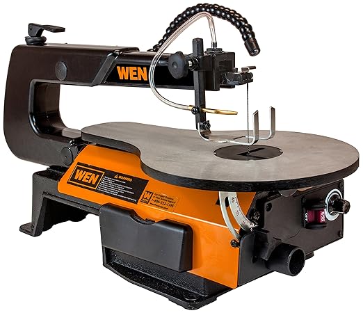

    I took a vacation day today (Friday) and spent most of the day working on the car. The cut-out for the right a/c vent is made, and the opening for the speedometer has been raised to clear the left a/c duct. Sadly my 30+ year old scroll saw broke while working on the left a/c vent cut-out. Replacement parts are not available, so I'll be making a purchase of a new one soon.

    Scroll saw? Do you mean jig saw?

    "WEN Model 531-Type1 Scroll Saw" written on the side of the saw. You may call it what you like, but it is so old that WEN doesn't even list it in their replacement parts section of their website. Hits on eBay call it "vintage". It is so old that the 2-prong electric plug doesn't even have one prong wider than the other.

    Oh okay. When you said scroll saw I was trying to visualize how you could use this tool pictured below to cut the AC vents on the dash. If you want to cut custom flat objects freehand with great control, scroll saw would be it.
    If you are buying a new jigsaw be aware! Many modern jigsaw models have very poor "shoe" locking mechanisms. My Ryobi model was impossible to cut perpendicular to my surface and messed up manyy cuts. Eventually got a dewalt which works well.

    Interesting. Your definition of Scroll Saw and Jig Saw are exactly opposite mine. Maybe somewhere along the way the two terms were swapped by the saw manufacturers. To me, your photo is a bench-top Jig Saw. My saw shown below is a specialized saw that has a feature where you can rotate the direction of the blade while you are cutting. Alas, I now also see online that the term Sabre Saw is used for a Sawz-all, which I have always known as a Cut-off Saw. This is all making me feel old and out of touch, since I always knew a Sabre Saw as the version of my saw in the photo that didn't have the turnable blade feature.

    From the label in your photo below, it seems to be new enough to be "DOUBLE INSULATED", in which case it may have been new enough that polarized plugs existed, but exempt from needing one.

    I think sawz-all, cutoff saw, reciprocating saw are interchangeable terms. Never heard the term saber saw. But my reference point is woodworking, not metalworking. Although I did work a bit in a metal shop but that was in milling machines and lathes.
    My ryobi saw had that rotating blade feature too. The problem was that the blade would rotate on its own anytime I hit a hard knot in the wood because that locking mechanism did not tighten well either.
