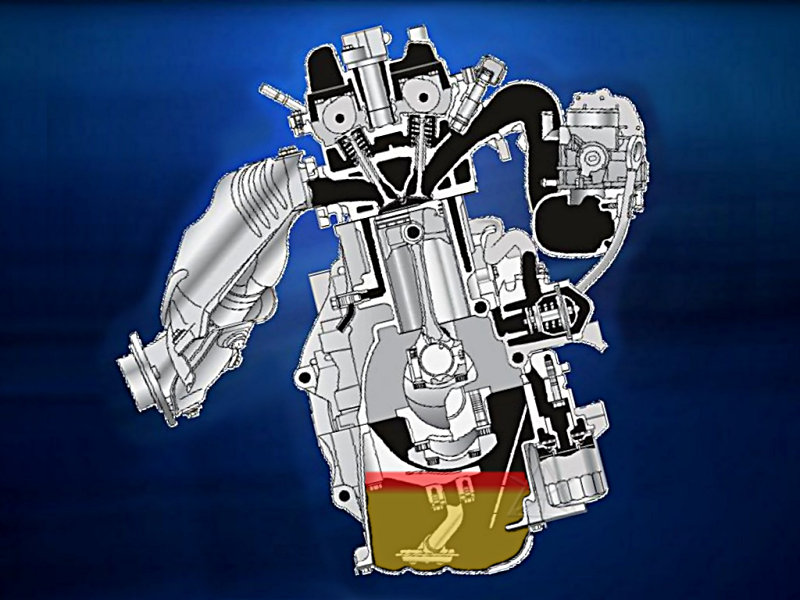

    This is about how the engine sits in the car, and the dipstick
    marks have been emphasized for your volumetric pleasure.
    _H*

    Hobbit, I'm confused by the picture: I can see what appear to be the ADD and FULL marks on the dipstick, but then exactly what is indicated by the red band of oil, which corresponds with neither mark on the dipstick? (I'm going to borrow your phrase "volumetric pleasure" :->)

    Simple. Gold is good. Red is bad. The exact boundary is
    fuzzy.

    Master Hobbit, may we say that the gold above the dipstick minimum line is better than the gold below it?
