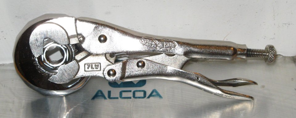

    Thanks for the suggestions, but I really doubt it would be possible to impart sufficient torque with any 3/8"-drive cap wrench, or any stamped-steel one, much less with your relatively short-handled Vice-Grip type plier.
    How much torque does it take to break the cap or the metal filter housing? Either would be a disaster!

    Crappy dealer service department or or quick oil change shop just one side of the problem but when I see people start using Mickey Mouse tool like one from OP pic below, LoL.., no wonder you can't take if off. Yeah, lets destroy that by hammering poor catridge cap to death.
    $40 later and new catridge cap is installed....
