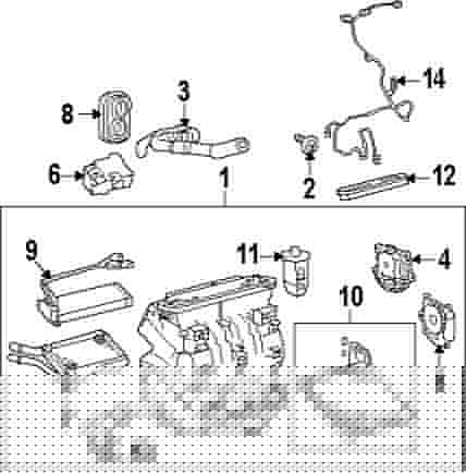

  15. n5160u
    n5160u Junior Member
    Jun 12, 2012
    22
    17
    The PIP has an electric heating element located above the traditional heater core.
    It is listed here in the Prius parts catalog as the "Quick Heater, item #9.
    Its not very powerful but in my area it is usually sufficient provided I don't set the heater output temp higher than 68 degrees. Going above that setting almost heater.gif
    always starts the ICE on my car.
