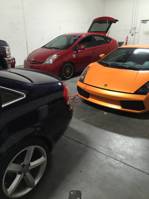

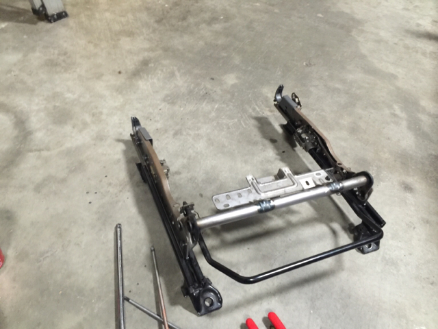

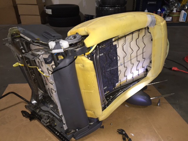

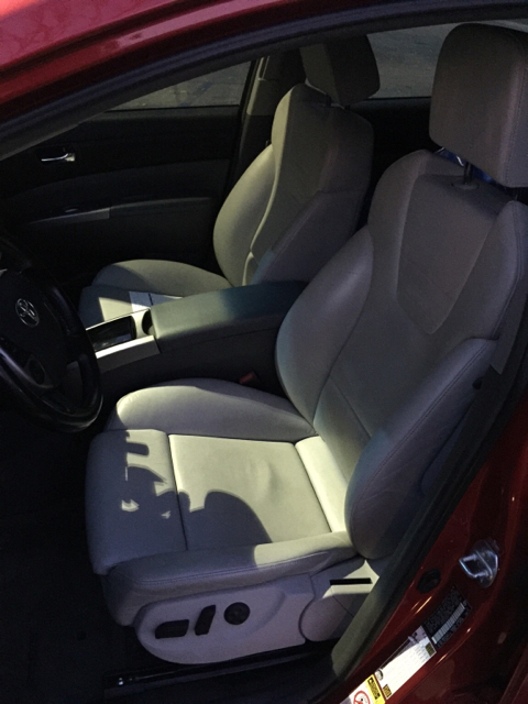

    The machine shop got the seats in!
    I took them out - which was a pain in the butt!
    I connected the electrical motor function to the 12v outlet from the console and its all good!
    Seat heaters
    I still didn't have time to power them up.

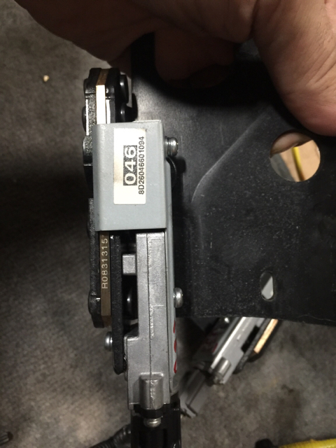

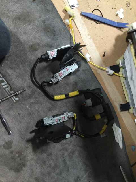

    Airbags

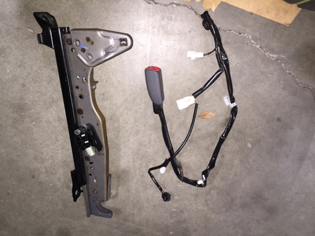

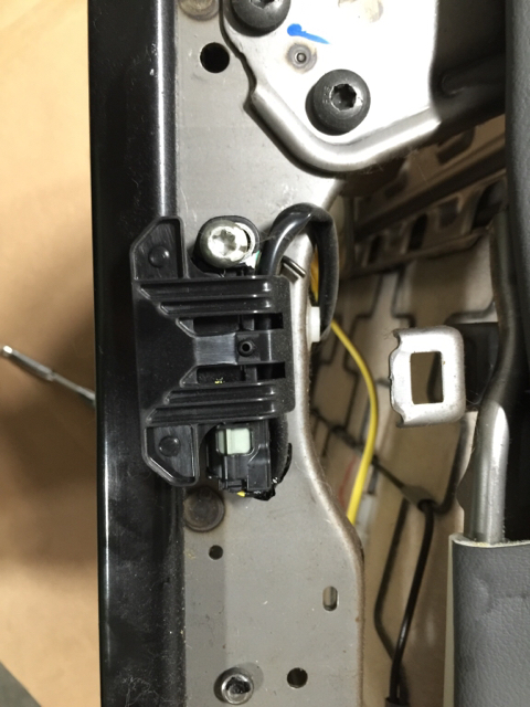

    Driver side is easier since there is only one hall sensor for the position of the seat.
    [​IMG][​IMG][​IMG]
    For a moment I thought of transferring it but it's not anything easy.

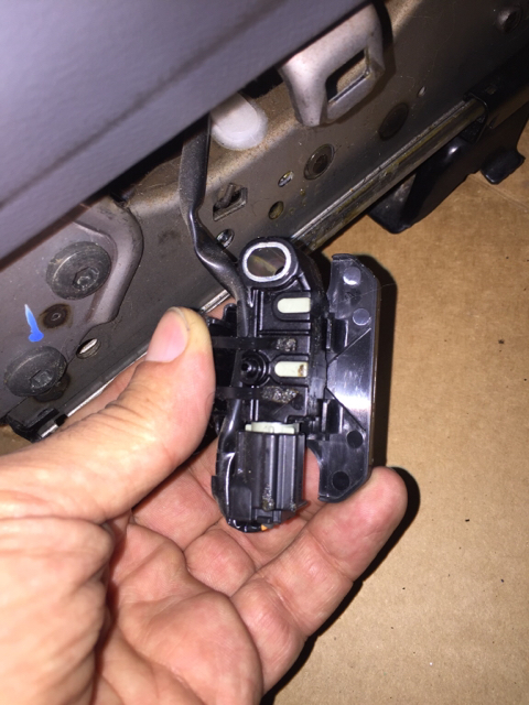

    Having not an easy way to get around this I decided to do something a bit ghetto / but non the less functional (I thought).

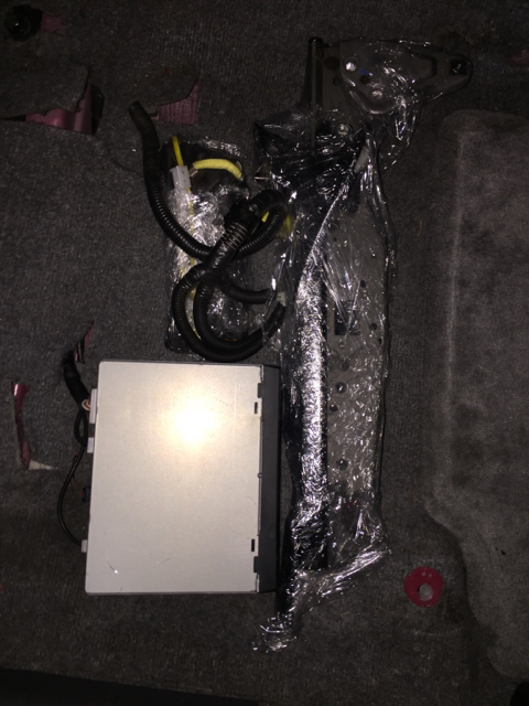

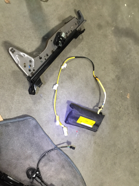

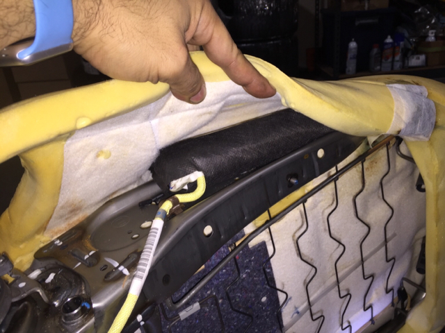

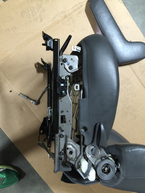

    I removed the rail with the sensor from the seats, and I also removed the airbag from the seat.
    [​IMG][​IMG][​IMG][​IMG]
    I wrapped everything up / nice and tidy (adjusted the one piece seat real roughly to my real position) and I connected them to the harness so that the blinking airbag sign will stop.
    If that worked my idea was next to connect the Audi side airbag to the Toyota outlet so that everything would be functional - the problem is though that the airbag light is still on (with the stock Toyota airbag connected, hall sensor in the railing), I'm not sure why.
    Can anyone check for me if the airbag illuminates when the seat belt is not buckled? If not I'm not sure why this is happening...

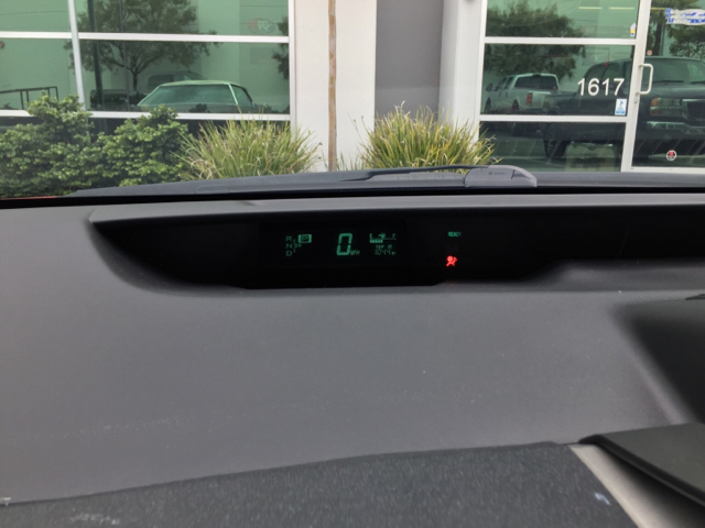

    Question
    Is the airbag sign (see pic) referring in both airbags or only drivers?[​IMG]
    Okay my friend Ken just confirmed that disconnecting any of the passenger side airbag related sensors will still activate the same warning light / so I think mine is because there are no sensors or airbags currently connected at the passenger side.
    My plan is:
    a) Remove all the sensors and side airbag from the Prius passenger seat and connect them to my car
    b) Check if the airbag light will go off.
    c) Connect the Audi seat airbags and see if that will trigger a light

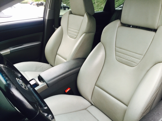

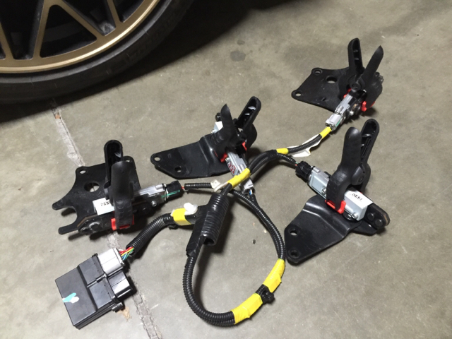

    Drivers side airbag from the Audi is connected and functional without any airbag lights coming on!

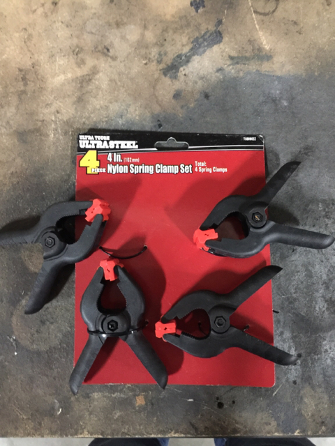

    Passenger airbag sensors are connected (so no airbag issues) but I can't make them feel there is weight in the seat / even though I did try with different clamps to simulate the passengers weight pressure
    [​IMG][​IMG][​IMG][​IMG][​IMG][​IMG]

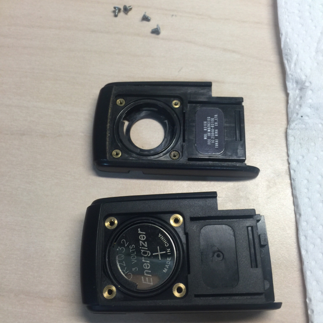

    I also got a new remote control case and I transfer all the electronics from my old remote! Now it looks so much better!
    [​IMG][​IMG]

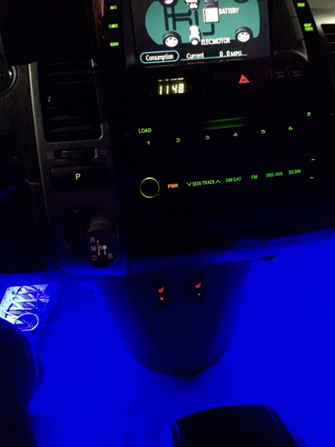

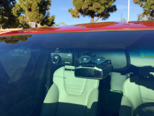

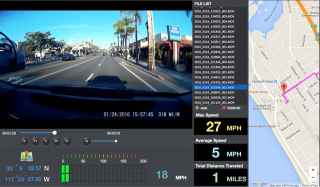

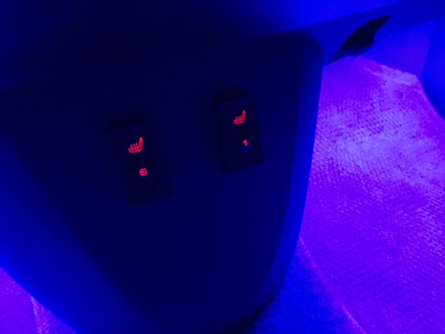

    I spent most of this weekend doing electrical work on my Prius but I'm glad 90% of it is finished!
    Audi seat heaters were installed (a new 12v line had to be pulled from the battery) and then I eventually hardwired my radar detector and my new dashcam (hopefully nobody will break in my car )
    I also buffed out and polish the hood since there were waterspots.
    [​IMG][​IMG]
    [​IMG][​IMG][​IMG]

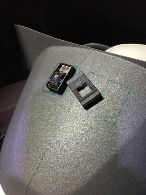

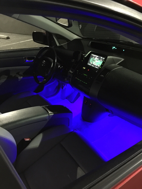

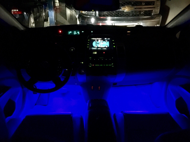

    The seat heater switches have been properly installed along with some hidden LED lights in the footwell area:

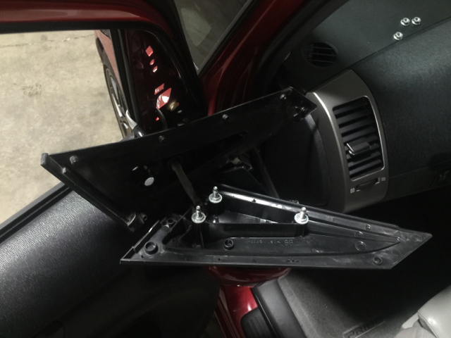

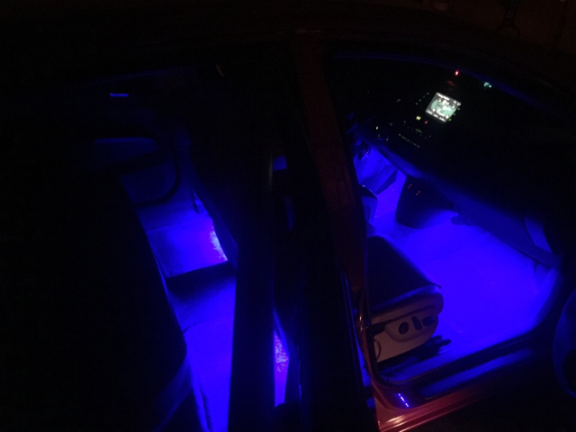

    Last night I also installed LEDs in the rear footwell area

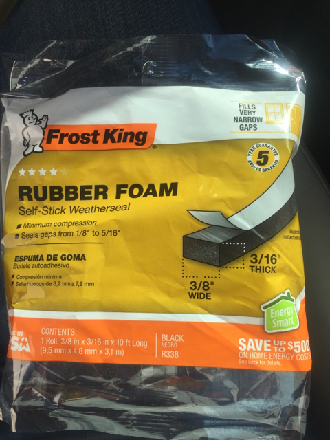

    Then I spent 5 min and I installed weatherstripping material between the driver's side mirror and the the door - completely eliminating the wind noise coming from that area.

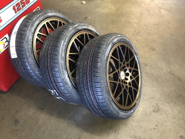

    What rims are these?
    They should truly look awesome on my wife's driftwood gen2!
  12. LamboGuy
    LamboGuy Junior Member
    Nov 23, 2015
    53
    21
    92008
    17x7.5 Katana KR20 Bronze wheels rims (42 offset, 5X100/114.3)
