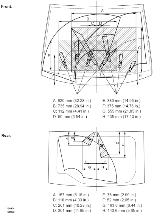

    The official Toyota repair manual says "Using a TOYOTA 4 Way Nozzle Adjustment Tool (part number: 95060–10010), insert the bumpy potions of the adjustment tool into the bumpy potions of the nozzle jet and make the adjustment. ... Do not use a metal pin or other such tool as it may damage the nozzle jet."
    Unfortunately I can't find anyone selling a 95060–10010 tool so it seems we're stuck with the pin. It also has a diagram (attached) showing where all the streams should impact the windshields. Since it shows positions for the rear windshield, that sort of implies you can aim the rear nozzles as well, but it doesn't actually say if they're aimable.
