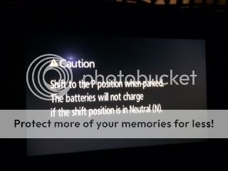

    Got something similar the other day when I needed to nudge my car forward a bit and had the door open when I put it in D. Message came up with a ! on the MFD. Spooked me but still went into Drive though.
    If it was this
    Close your door and try again?
