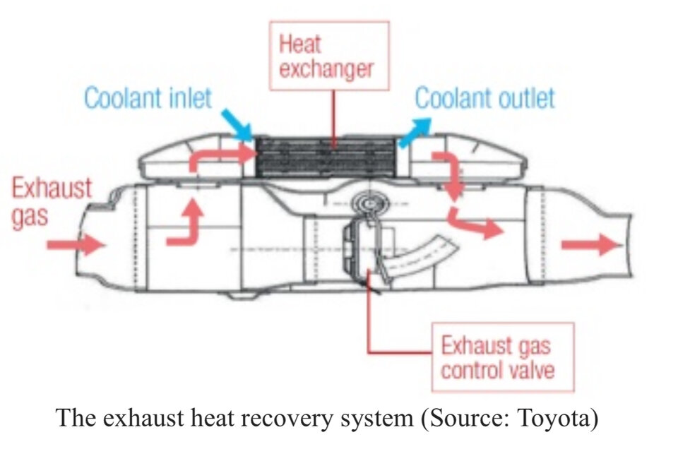

    The 7C0 thermistor is monitoring the output of the exhaust heat system, which is only in full use during warmup. It also has a mechanical thermostat which allows exhaust to bypass the exhaust heat system's heat exchanger. I have heard of one case where that mechanism failed causing too much heat to 7C0. It's not clear to me that would actually overheat the engine since it's a small flow which is always picking up some heat from the exhaust no matter what.

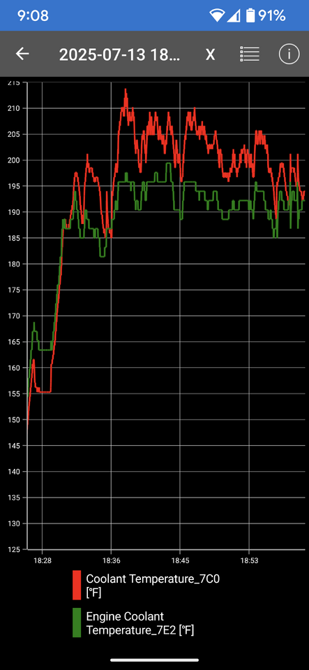

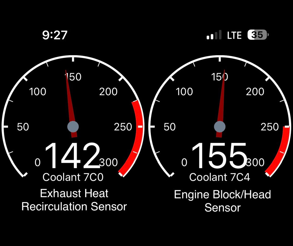

    @ChapmanF @rjparker - Chapman I read through a thread where you tested the ICE shut down upon overheating. You had mentioned the sensor that sends the signal to light up the coolant light on the dash. Do either of you know what sensors cause that light to come on? I've been monitoring both of the sensors that rjparker mentioned and they are usually close but the 7co rises faster and higher than the engine 7e2. No dash light on this drive. Ambient temp was 106-108, although not a "hill" elevation was increasing going due south to north in Phx, cruising speed mostly but you can see the increases during merging and/or more ICE effort. I just don't know what would be "normal" for the 7co data. The trends for both are pretty darn close. I appreciate all the time you have spent helping me with this.

    Both of the temperature sensors that you are now monitoring can turn on the high temperature warning light on the dashboard.

    The light is built into the combination meter. The 7C0 exhaust heat recovery system sensor is wired straight to the combination meter, which directly turns the light on at 248 ℉ (120 ℃).
    The 7E2 cylinder head outlet sensor is wired to the ECM. The ECM and the combination meter are connected over a communication network, and messages pass over the network to turn the same light on when this sensor reads too hot. I assume "too hot" is probably also 248 ℉ (120 ℃) for this one also, but I have never gone out and tested that like I did for the EHRS sensor, so for all I really know it could come on at some other temperature for that one.
