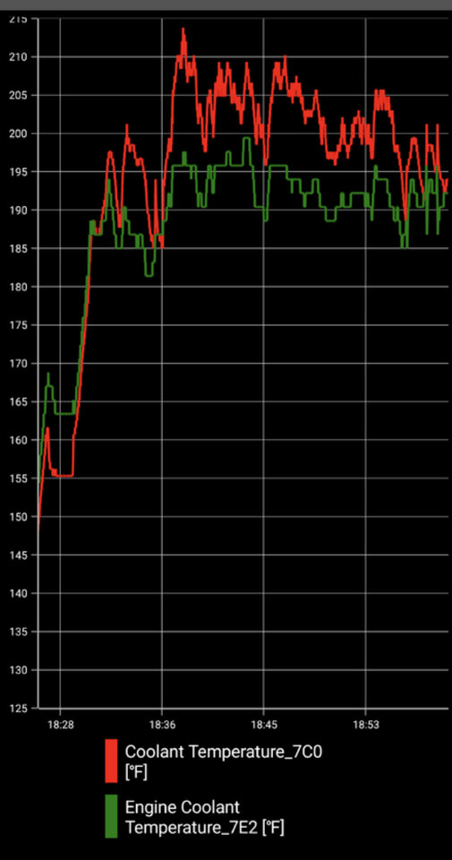

    Would it be logical to make the assumption that when my light came and went that it wasn't the EHRS sensor causing it since your test caused a shutdown of the ICE? Mine never shut down, I immediately took the foot of the accel. and the light immediately went off; which may or may not have been just a coincidence.

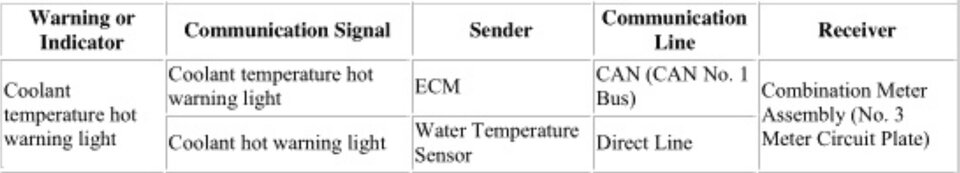

    Yep, sorry, forgot about that parameter. Is there any other sensor that can set off the coolant light that I should be monitoring or is it just those two?
  5. ChapmanF
    28,743
    19,041
    No other that I know of, but I'm not claiming to know everything.

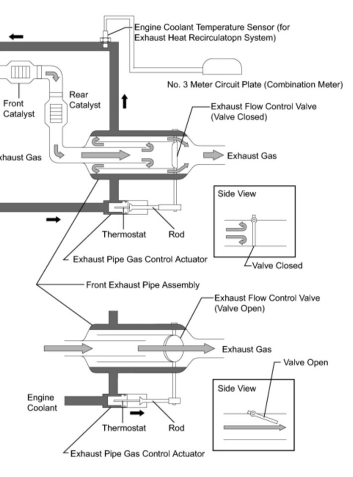

    The Car Scanner app developer is routinely changing the custom "connection profiles" that decode manufacturer specific points. He had an update about three days ago and the water pump rpms don't work even though the points are there. I sent the developer an email yesterday. The problem is he configures this app for almost all cars so I don't know how he can properly test changes.
    I would expect the exhaust heat recirc sensor 7CO to be slightly hotter since its source of coolant is the output of the engine. So it starts with coolant at engine temp and heats it more until a separate thermostat bypasses the exhaust. This flow is small compared to the larger engine to radiator flow and is further split between the egr cooler and the exhaust heat recirc system. I suspect the warmed up secondary flow heat increase is negated by the egr cooler. I normally find both sensors to be within a few degrees of each other when both mechanical thermostats have operated, eg at full operating temperature.
    Part of the problem with visualizing these flows is Toyota does not have an official flow diagram for gen3. There are sketches from the gen4 to gen3 engine experiments but each ends up being a compromise solution for those engine swaps.
    As noted earlier, the exhaust recirc thermostat could be stuck in the heat exchanger position adding unnecessary heat after warmup. This was reported at least once. The engine temp could be fine but the exhaust heat exchanger sensor could trigger the light.
    Testing the thermistors is as simple as verifying their readings after an overnight cooldown. They should read within a few degrees of the car's outside ambient temp as displayed on the ac controls. The connections are unlikely as it takes 40 or more ohms resistance to change ten degrees in most temperature ranges.
    Your engine sensor is well within normal but you may not be monitoring at high engine load. Outside temperatures have little impact with a normal cooling system. But reduced cooling capacity is always possible as noted in Chapman's earlier post. If it's reduced cooling capacity I would expect the engine sensor to rise significantly above 204f under high load and be slow to recover.

    The flow is from the output of the engine, through the cabin heater, then splitting off between the EHRS and the EGR cooler. So, during heating season, it will have given up heat to the cabin and will be coming in cooler than at the engine outlet (which is desirable, to increase the rate of heat exchange into the coolant from both the EHRS and the EGR cooler). During cooling season, of course, the cabin air mix will all bypass the heater core, and the coolant should be coming out still close to the engine outlet temperature.
    I'm not sure what you meant there, but the direction of heat exchange is from the exhaust gas into the coolant, in both the EHRS and the EGR cooler. In one case the purpose is to raise the coolant temperature, and in the other the purpose is to lower the EGR gas temperature, but the effect of both is that the coolant temperature goes up.

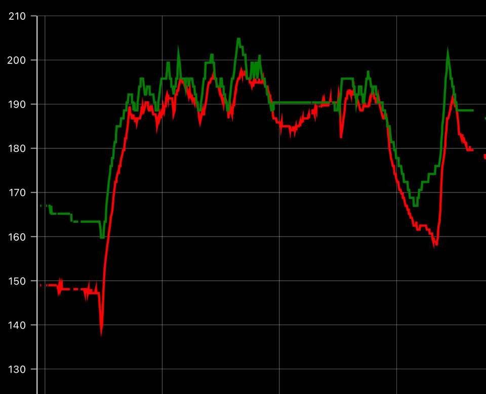

    Your two temps with the Exhaust Heat Coolant Temp 7C0 exceeding normal Engine Temp
    Same two on my v with full ac and periods of steep grades. Note Exhaust Heat Temps essentially at or below Engine Temp. Engine temp briefly reaches 204f under load. IMG_8918.jpeg
    Time ~8 minutes per horz x axis interval
    Detail of Engine Heat Recirc System
    I also verified with Techstream the 7C0 Car Scanner point comes from the Combination meter.
    Might be time to check the Exhaust Heat Recirc System especially if the Engine sensor never significantly exceeds 204f.

    EHRS parts were replaced about a week ago. It has definitely made a difference to the temps. The EHRS temp is almost always under the engine coolant temps. When the EHRS does go higher it is under heavy load, maxes at 203. The engine coolant temp starts to increase to about 196 and then the EHRS temp falls to within a degree or two. As soon as the load is decreased to "normal" both fall back to 186. The slopes of both graphs are almost identical. Thanks everyone for the help with this!

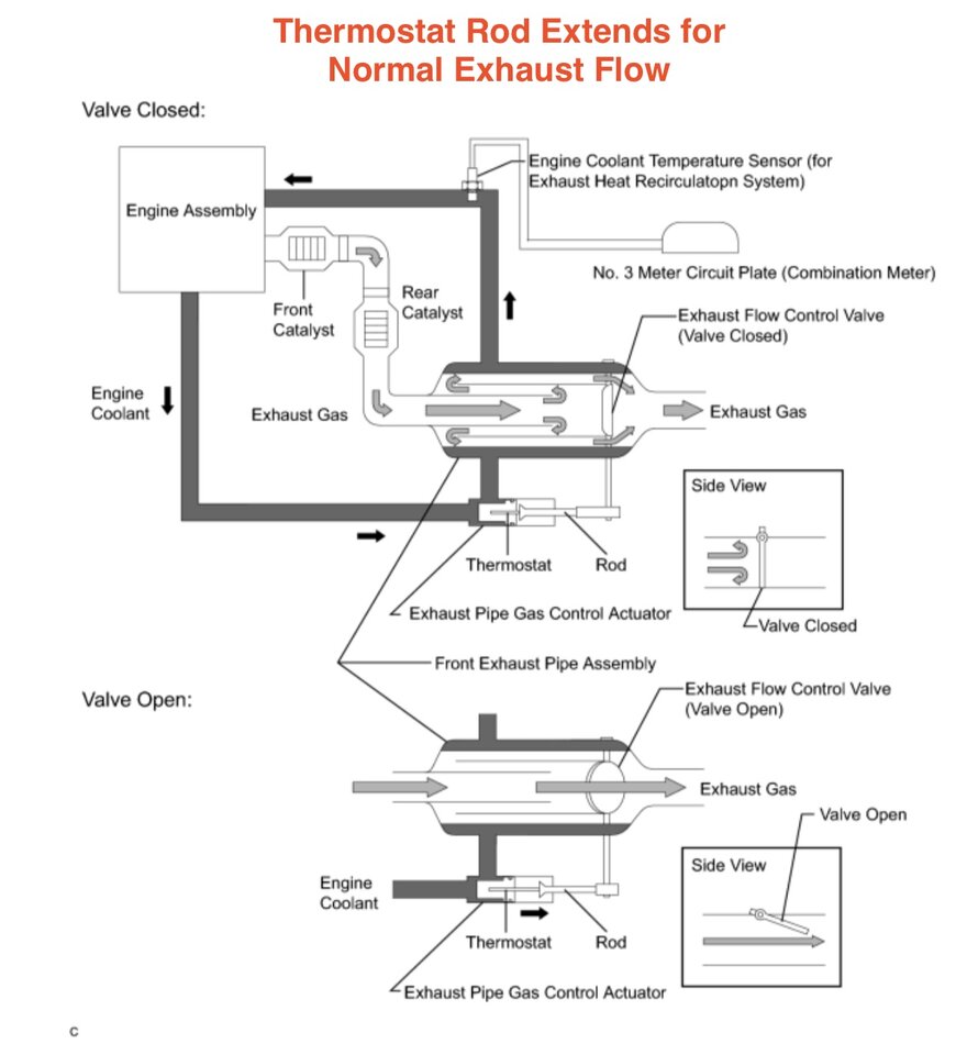

    Krótko mówiąc, mam nową, oryginalną pompę wody i nowy płyn. Martwi mnie jednak temperatura, która średnio wynosi 95 stopni Celsjusza (91 C). Dzisiaj byłem pod samochodem i zauważyłem, że siłownik katalizatora, odpowiedzialny za sterowanie przepływem wody w nagrzewnicy, jest zablokowany. Dlatego chciałbym go przez jakiś czas monitorować za pomocą aplikacji. Siłownik jest zablokowany w pozycji całkowicie wysuniętej. Nie mogę go ruszyć, więc odpuściłem.

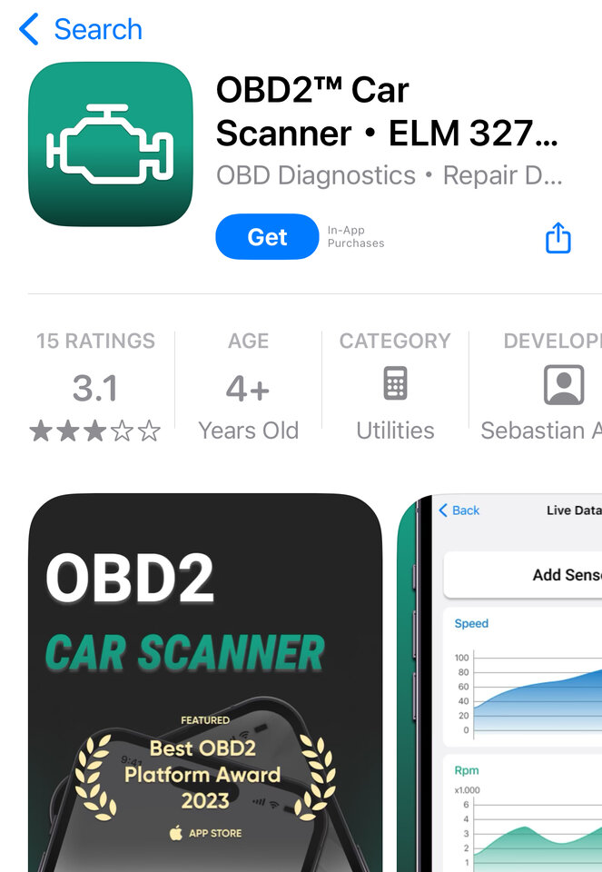

    The phone app I used above is "Car Scanner Pro" for Apple IOS. The Pro version is an upgrade within the app.

    The exhaust heat recirc system actuator does not block coolant flow to the heater, instead it reroutes it internally through a heat exchanger to warm the coolant faster.

    The app is "Car Scanner ELM OBD2".

    Dziękuję za szybką odpowiedź. Mam Car Scanner Pro, ale niestety nie wydziela się tego czujnika (poszukam jeszcze raz). Poznałem również schemat działania tego systemu jako atakującego w tym systemie. Martwi mnie jednak, że siłownik jest wypchnięty i nie mogę zrozumieć, jak działa. Jeśli jest silnik zimny, czy oznacza, że jest wypchnięty, czy ukryty? Czy jest jakiś film odprowadzający do? Dziesięć zamknąć zamykające klapkę wewnątrz katalizatora. Byłoby wiedzieć, czy wysunięty siłownik, czy klapkę; wpływ na wpływ na cały silnik, strukturę i układ wydechowy. Niestety, nie będę mieć dostępu do gniazda w przyszłości, ale kiedy będę mieć połączenie z innym urządzeniem, takim jak źródło dostępu lub inne części.:)
    Ups, spojrzałem jeszcze raz na schemat i wygląda na to, że wysunięty trzpień siłownika oznacza, że klapa jest otwarta, a spaliny swobodnie przepływają. Pytanie brzmi, czy mogę żyć z tą wadą.:)

    Yes. The engine just warms up a minute or two slower.

    Somebody reported a situation once where the rod had fully extended, but the lever it pushes on had slipped beside it, so the valve was in the cold position still.
    For clarity, just as the diagram above shows, the valve in question redirects exhaust flow, not coolant flow.
