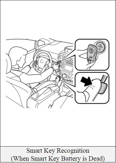

    new to me 2012 v two. Is there a dash slot for the fob? Is it sensor only, what if the FOB battery dies?
    Stupid? Too lazy to look in the book? Go ahead dis me, but I didn't see a slot.

    I would carry the book with you as you may want to know how to jump start it, how to start it with a dead fob battery or how to stop it when the Start button does not work (hold down over 3 seconds). There is no slot. It's similar to the tags that keep you from stealing the good stuff at Walmart but the tag is in the fob. By the way the answer is in the first post above.

    yup lazy, I searched for fob and slot in the v forums first, and got... nothing. Perhaps you can read the tea leaves that said there is no slot in that first post. Dumb me couldn't. I'm coming from an 05 with a slot. Book, shmook, that's why god invented forums, now if he could just work on that search engine a bit.
    Have a WM employee put the good stuff in the dumpster, there I helped you out too.
    I'll guess the book doesn't mention slot either. Is the book in searchable form somewhere?
    If I ever find a manual that says product X does NOT do this, I'll eat it.
    Well somewhere there's a sears lawnmower manual that says don't pick it up and use it as a hedge trimmer. (after the lawsuit)
    So there is an RFID sniffer , somewhere around the start button, no fob battery needed if the fob is in THAT area? explain THAT to the parking attendant. (I have a story about how an attendant cleverly locked me out of my 05)
