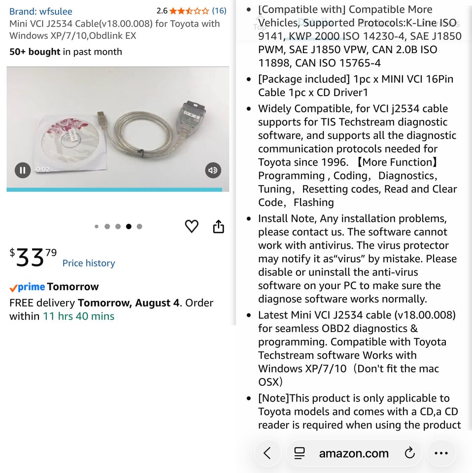

    I'm past the level 1 support at ThinkCar, so hopefully they will confirm if ThinkDiag2 can read subcodes. . If not, is anyone willing to suggest an OBD reader that will read Toyota subcodes without spending > $500 to do it?

    Still dealing with ThinkDiag. At this point they are giving me the run around. not answering my direct questions about the limitations of their ThinkDiag2 (or any of their other OBD tool's ability to read INF sub-codes for that matter). In the meantime, my G2 just sits, so I'm pretty disappointed.
    Is anyone willing to suggest an OBD reader that will read Toyota subcodes without spending > $500 to do it or am I stuck making the investment in a Techstream setup?
  17. rjparker
    rjparker Tu Humilde Sirviente
    Jun 6, 2008
    11,117
    6,975
    Texas Hill Country
    Some with a win7 or win10 laptop w cd drive would buy one of the mini-vci obd2 interfaces with the hacked older version Techstream.
    Sometimes tricky to install. Read vendor limitations above.
