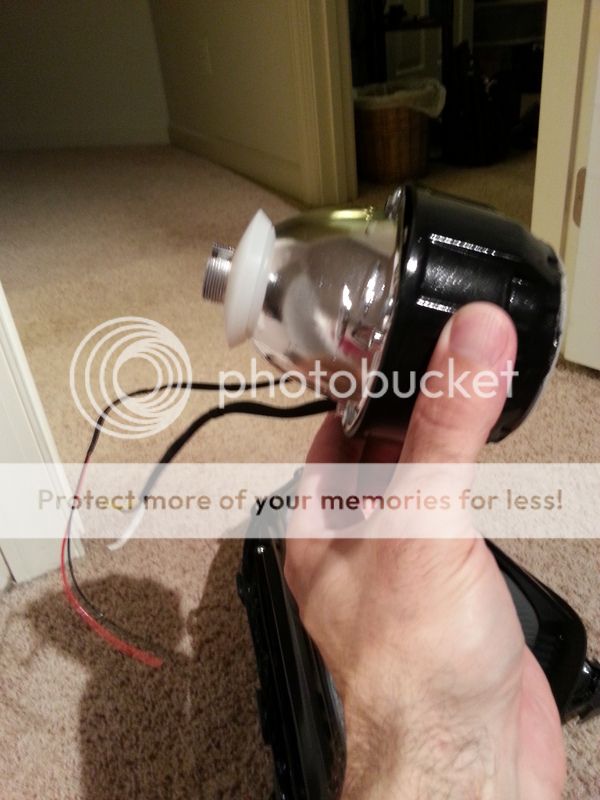

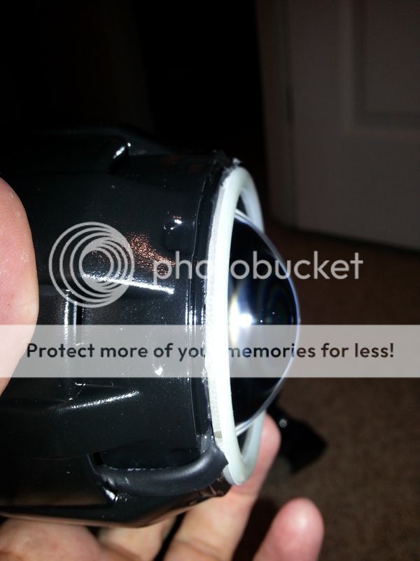

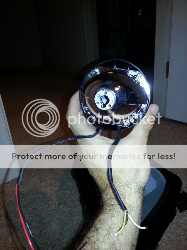

    The Halos in my Prius are actually Poxy'ed, no wires like in the 4Runner. I used JB kwik, it's more than enough. and I used heatshrink to cover the wires. I'll post pics later tonight.

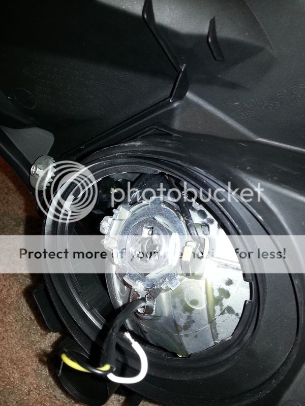

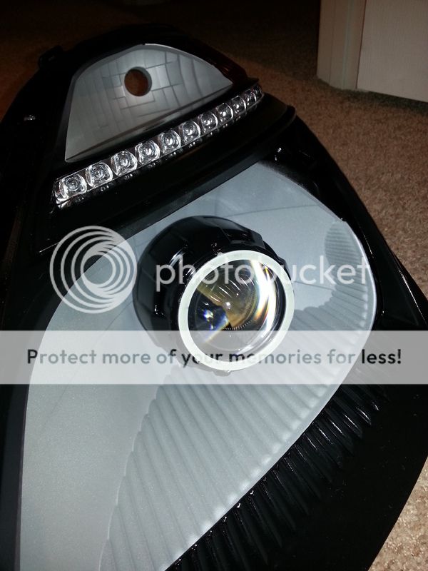

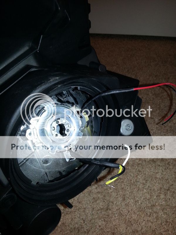

    [​IMG] [​IMG]
    [​IMG] [​IMG] [​IMG]
    As you can see, it's really not that hard, just take your time. As you can see, the H1 mini reflectors will fit right in. Few things off top of my head now:
    Before you put everything back together and you seal it:
    1. Do not tight the H1 mini reflector nut super tight, just hand tight it first. Install the headlights on the vehicles and make sure your reflectors are aligned in a straight line, you will have to rotate clockwise or counter to get the line (cut off) straight, while trying to get your beams aim in the general area/spot, not perfect, but you want to make sure it's no completely out of whack either. Then tight it down, these are crush thread, so once you tight them down all the way, that's it, no going back. You can aim the beam to perfection afterwards with the elevation and side to side adjustment screws of course.
    2. Before you seal it down, give it a good clean. Wipe down all that dust and fingerprints/oils off of the lenses.
    3. Don't tape the Halos wired to the H1 mini reflectors like I did with my 4Runner, it is dumb and it may only cause problems with overheating the wires. Yes these are HIDs, but they still create heat, and taping wires to a hot metal reflectors it's not a good idea.
    That is all I can really think aside from my 4runner thread and the rest, it is really not hard, it just takes patience. Just take your time, do a little at the time. Maybe the others can chime in, but once you start, everything will fall in place. Good luck!
