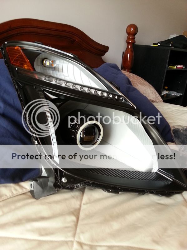

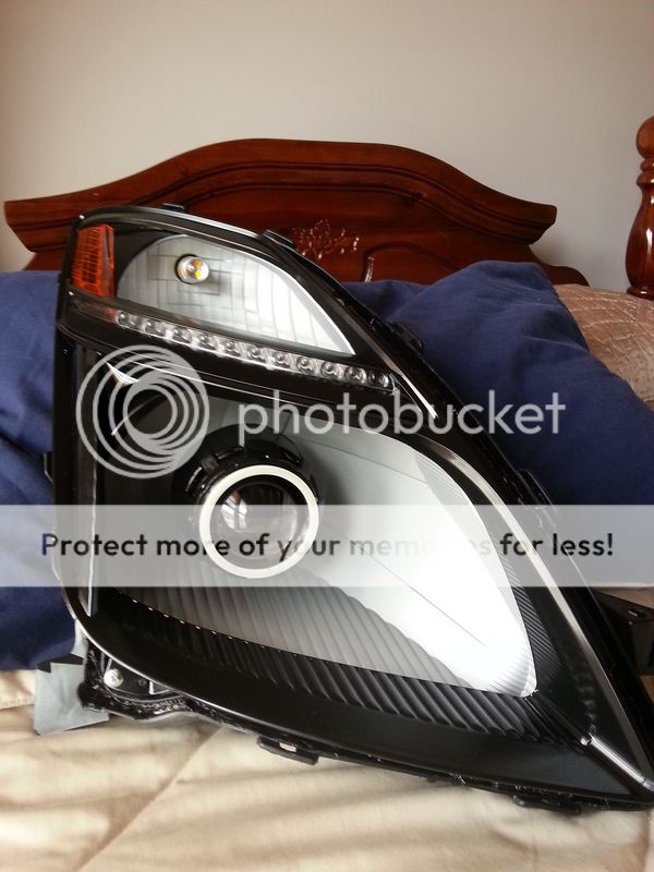

    Did some more work on my retrofit... almost complete

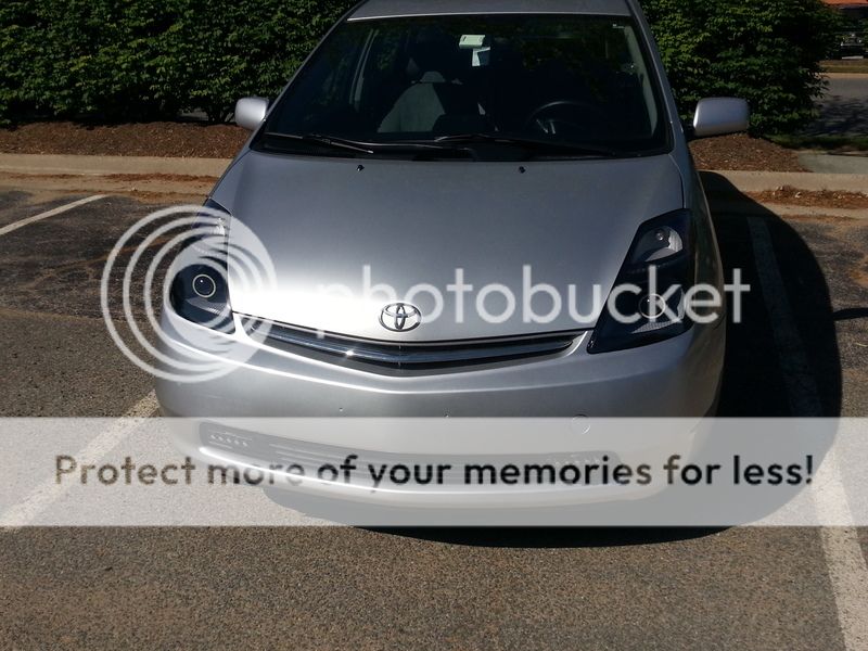

    FINALLY! All finished. I will take some better pics tomorrow during daylight, but here is a preview[​IMG]
    Etienne and Justdidit like this.

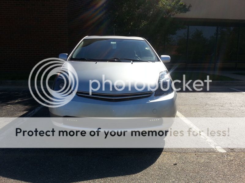

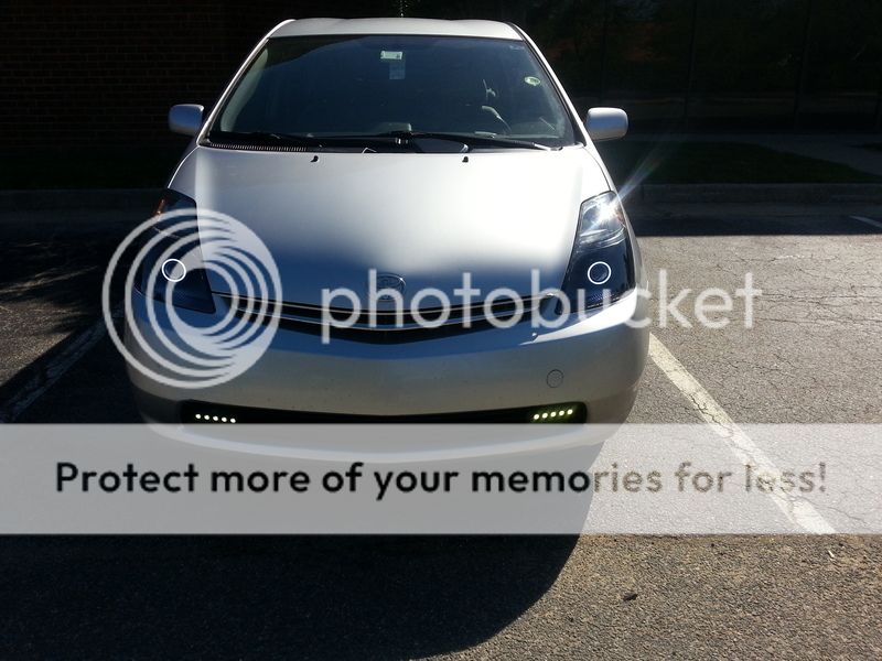

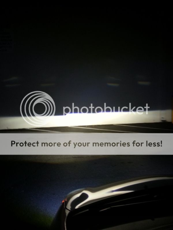

    Ok guys, here are the pics in the daylight, full sun.
    First off
    Now On
    Now this is with the sun directly behind me, super bright. The next pics are on the opposite side with a building behind, still in the sun.
    [​IMG] [​IMG] [​IMG]
    And finally, small demo with the Halos Switchback.
    Ajourney101 and Etienne like this.
