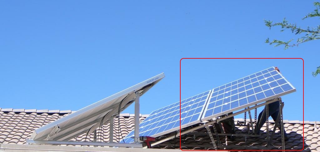

    I have ridge vents, and live further south than you by a chunk but my ridge line is almost N/S so the roof facings are more E/W.
    I'm thinking when I go solar I'll do somthing like the stand on the right in the picture below to tilt the panels towards the south from the eastern side of the roof. Unlike the pictured roof I have asphalt shingles and my lot has some trees that are much taller than the house but the roof is big enough to have large sections that remain unshaded.
