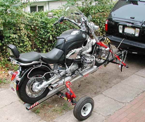

  7. cyclopathic

  9. cyclopathic
    cyclopathic Senior Member
    Apr 15, 2011
    3,292
    547
    2014 Prius c
    Just leave the Prius and take bike. Or leave the bike and take Prius. I have done both ways, and it works well. ;)
    with respect to bumper hitch carrier, unless you carrying cross bike IMHO it is better to go with something like trailer in the bag.
