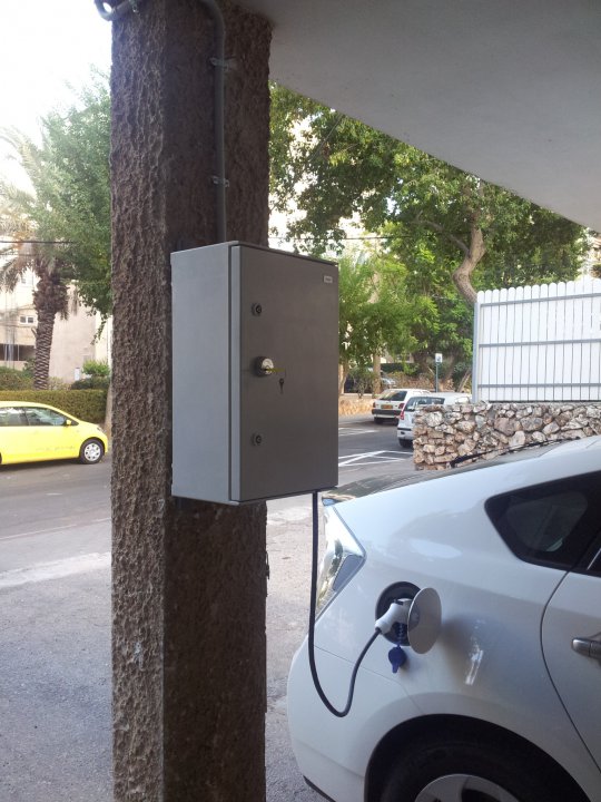

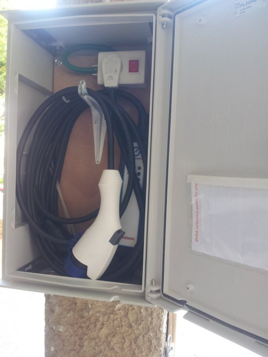

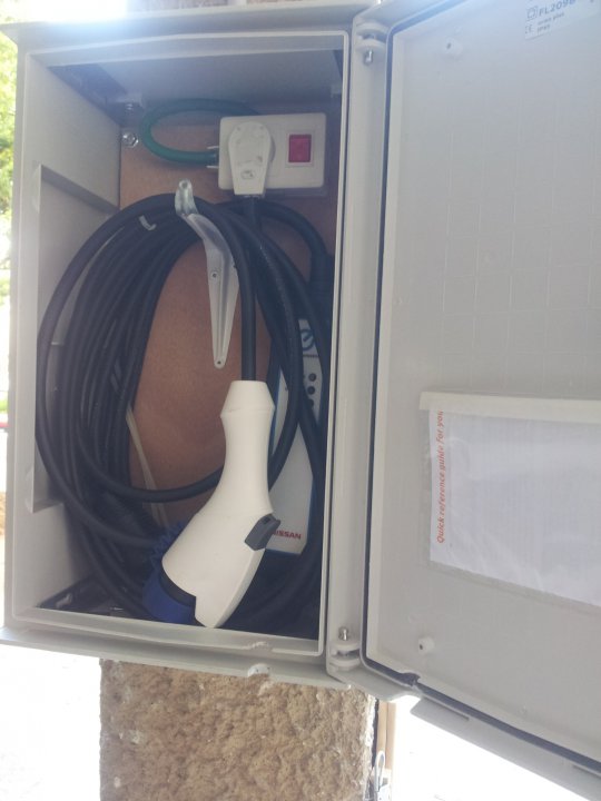

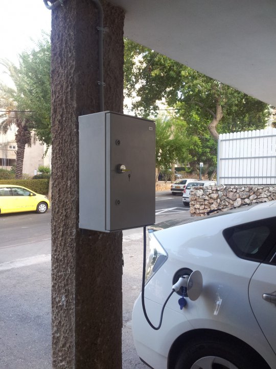

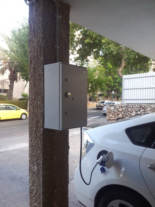

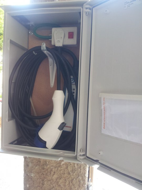

    For 'quick' charging (90 minutes) you need a well protected 240V outlet (dedicated circuit recommended). If you have such an outlet and your portable EVSE cable is upgraded (as you say) to 240V, you can DIY "charge station" in less than $100 and impress your neighbor.
    Below is what I did (our std voltage is 230V)
    The box is IP66 protected and has a lock. costed me about $30. You can see I added a 3/4" thick plywood board screwed to the inside back for easy mounting of components. See also the drill (half circle on the box and half on the cover door) for the cable to charge with the box locked (to protect from the neighbor...)

    I like that setup.. I like the BOX ..looks to be like 12x20x8 am I right?? Were did you buy it ? Thats just what i need

    The box is 500l x 300w x 200 mm deep (yes, about what you estimated) made from FRP by Hager - a well known European supplier of electrical components and accessories. They have many standard sizes.
