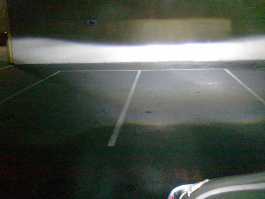

    This is what a good HID setup looks like.

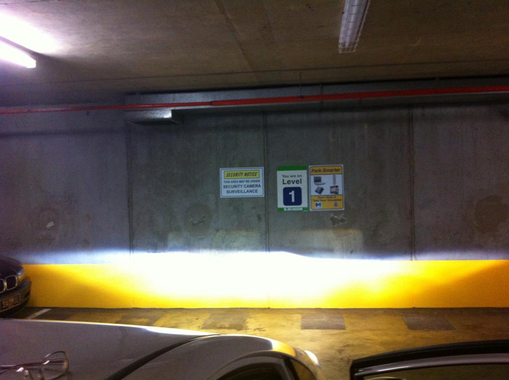

    this is what a drop in kit looks like in the Gen 3 projectors
    and another one

    If the difference between pic 1 and 3 are not good enough for you, then a lot of factory HIDs system maybe as well. Also the photos are taken at different distances. Clearly pic 1 was very close and pic 2 and 3 are further away. I'll have to shoot one when I get a chance.
    What doesn't seem to look right is pick 2 and 3. they don't seem to look the same.
    Actually pic 3 shows it's cut off is pretty good using the car on the left as reference. The cut off is right around the hood.
    The little rectangle boxes are from the 194 bulb not due to poor projection.

  13. zhenya

    I almost used this same picture to illustrate what is wrong with these setups. The Prius drop-in kit has massively bright hotspots in the center because the optics are all wrong. It's overpowering part of the Odyssey's factory system, but what we can see of the Honda's is a much more even light source. Cut off is the wrong thing to be focusing on in determining these kits effectiveness.

    I'm not sure what you mean by your first sentence. Picture 1 shows a good system with even beam spread. Pictures 2 and 3 show hotspots and even the cut-off being wrong (bowed in pic 2 which is far enough from the wall to show the effect) with drop ins in the halogen projectors.
