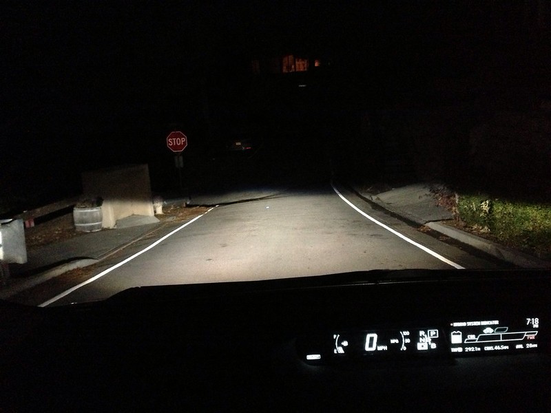

    Memory serves me right but I think these photos makes it obvious. I was very impressed with the Prius when I put in the HID's. I thought it was better than OEM or as good as but never really compared them back to back.
    Since this thread started the debate, here's my comparison of 2012 Lexus Rx350 OEM HID's with adaptive against my 2013 Prius with Xenon Depot's Volt 35 watt AC ballast kit.
    What the photos don't make obvious is the Prius HID's are brighter.
    Here's the photos. The stop sign is a good way to see out good or poor the cutoff is as well as street after the sign. The road clearly shows how the beam spreads are. I was able to see more detail with the Prius setup. If anything, I wish it was the opposite as I paid a lot more for the Lexus than the Prius! You be the judge.
    Lexus 2012 RX350
    2013 Prius.

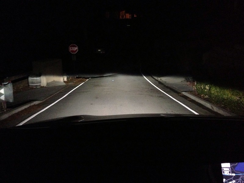

    If memory serves me right but I think these photos makes it obvious. I was very impressed with the Prius when I put in the HID's. I thought it was better than OEM or as good as but never really compared them back to back.
    Lexus
    Prius.

    Sfcyclist, just because the Prius aftermarket HIDs are brighter doesn't necessarily make them better. There's such a thing as being too bright, where the glare reflected back causes your irises to contract and limit your night vision.
    That's why foglights are aimed down low, so the light doesn't reflect off the fog and haze back into your eyes.

    In the photo where's the glare due to poor cutoff? Does the stop sign look brighter in the Prius photo? My point is basically to show the stock projectors work darn good with HID. Proof is in the photos.

    Would you deny simple physics and geometry too? The more light your HIDs put out, even at a low cutoff angle, the more likely it is to reflect off a surface into someone's eyes, especially if the surface is wet. It's like the rock skipped off the surface of a pond, the lower the angle when it hits, more distance is achieved. So yes, you may have a good cutoff, but more light means more reflected glare off the roadway into other people's eyes. Period.

    I don't think those photos show what you think they show, primarily because it's impossible to tell anything of use from photos trying to illustrate how much they illuminate. It's also impossible to tell whether you've increased the amount of light in one area, to the detriment of another. You can't judge light output quality by eye. The fact of the matter is that it's technically impossible for you to place HID's in an assembly meant for a halogen light source and NOT produce some level of glare. The fact that the cut-off blocks it on level ground doesn't make it ok.

    I said that you cannot judge the quality of light output by eye. I did not mean for you to read that as an implication that you adjusted the photos. By changing the bulbs you may have increased light intensity in your immediate foreground, but you also by necessity, must be spreading additional light in areas that you did not intend to. That's the point; you install a light source not designed for the reflector and you have no control over where the light goes and your vision is not a reliable tool in deciding if you've made things better or not. That's why we have stringent standards.
