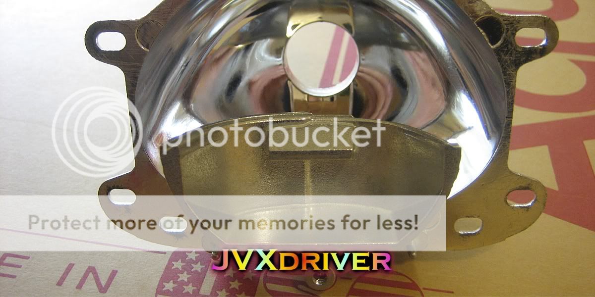

    Here's a shot of the TSX projector screen.
    Notice the curve vs the the flat one on the Prius.

    Interesting as I also own a RX350. I posted photos earlier in this thread and found the cutoff nor output so impressive. It's hard figure out what was done as the owner noted it was done by Light Werkz. Also, the HID may be more powerful than my stock RX's. Or perhaps the projectors were pre 2010 RX350?

    I have two set of HID projectors, also known as a quad setup, but to increase the intensity of the RX350 projectors, Clear lenses were put in. OEM RX350 projectors come with fresnel lenses. Having clear lenses increases clarity giving you that super sharp cut off and better over all light output. But halogen projectors will work with a plug in play HID kit, all though not really recommended, and is also frowned upon by "lighting enthusiast" . I have both 4300K HID bulbs in mine. They have the best lumen output.
