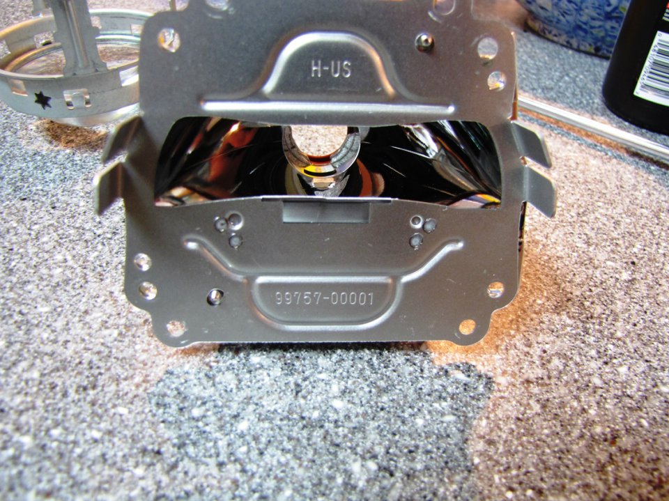

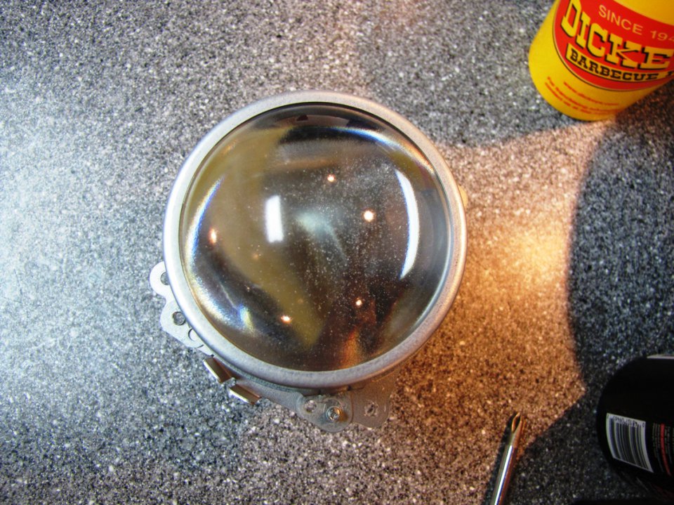

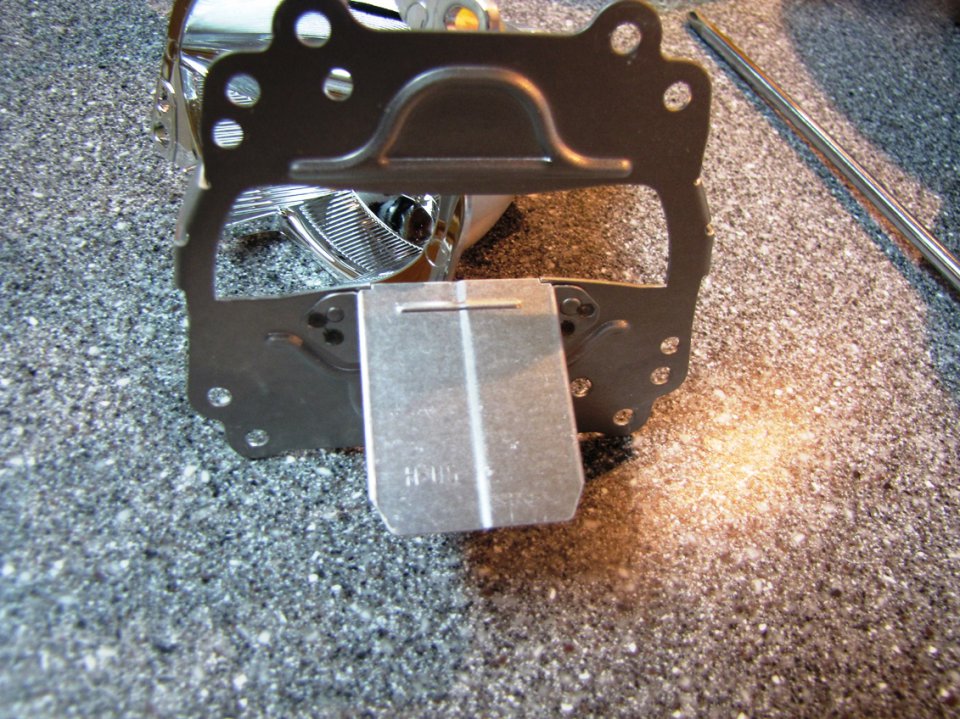

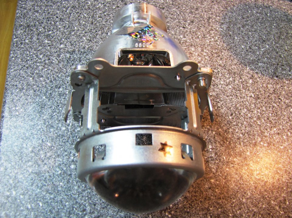

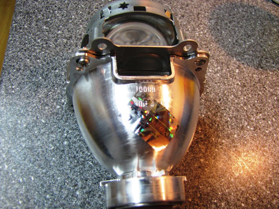

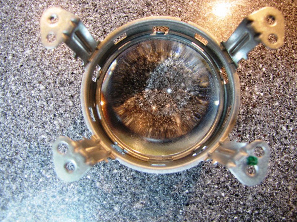

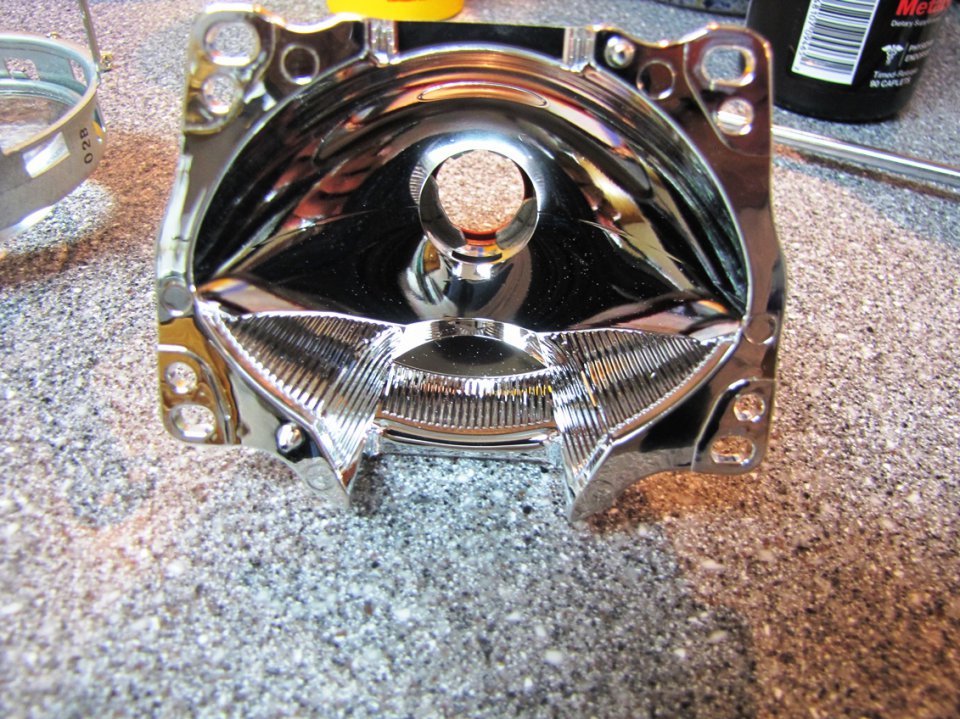

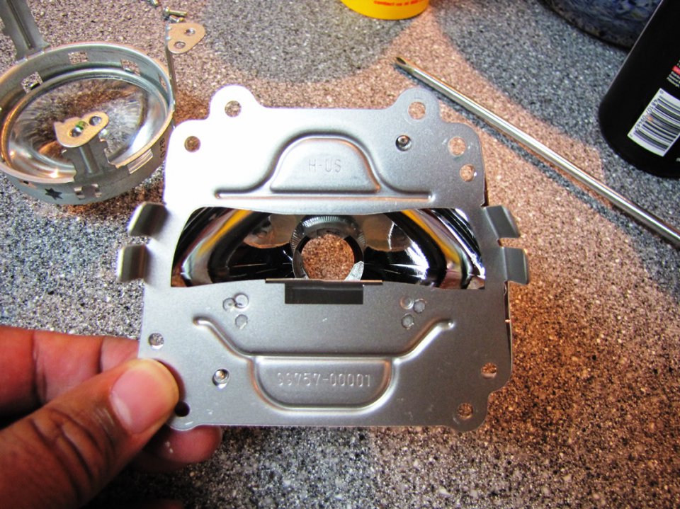

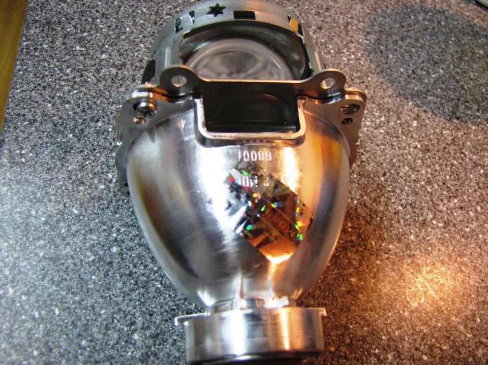

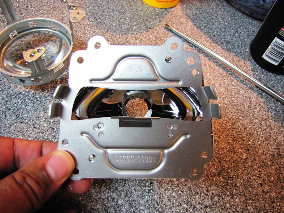

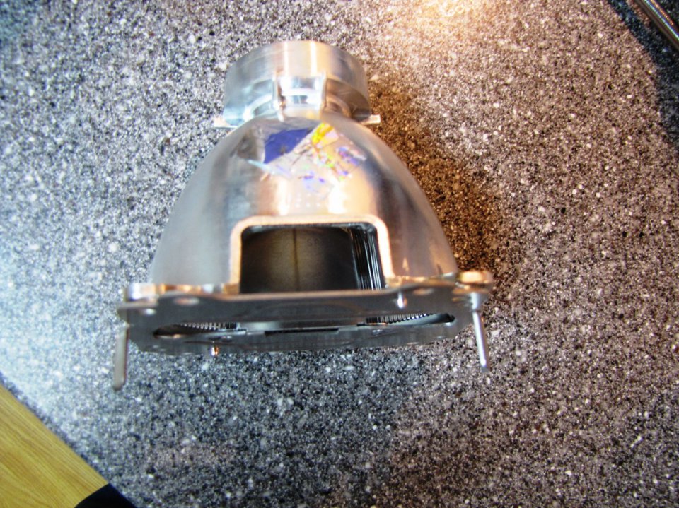

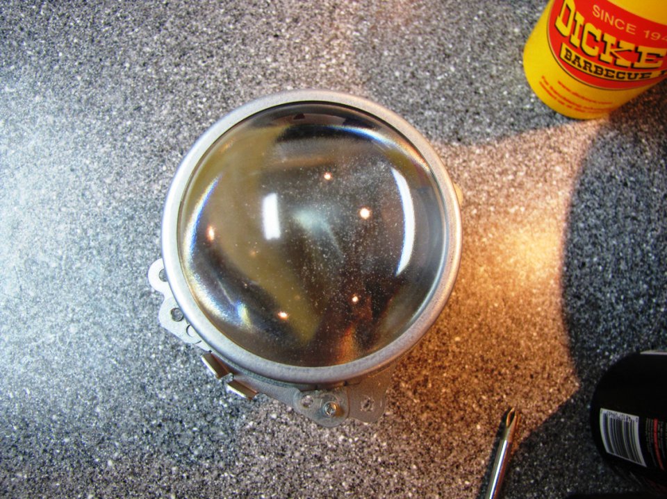

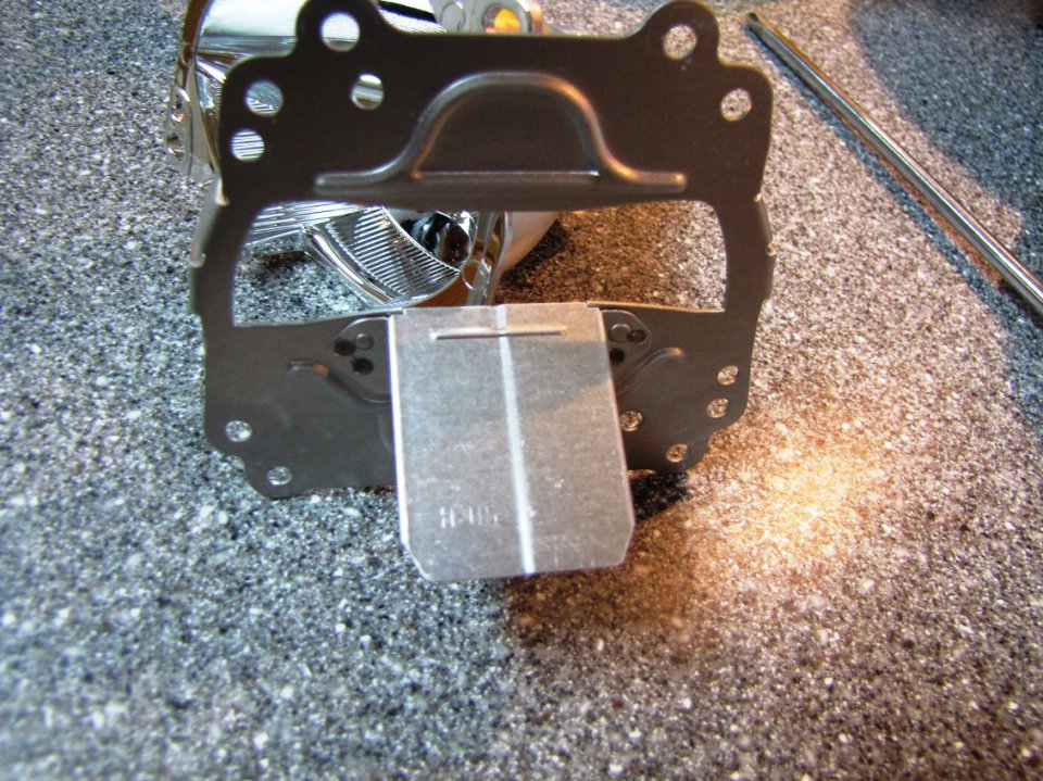

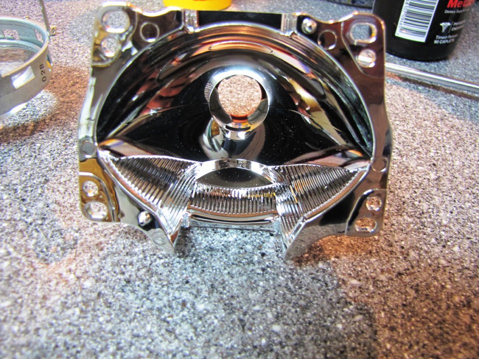

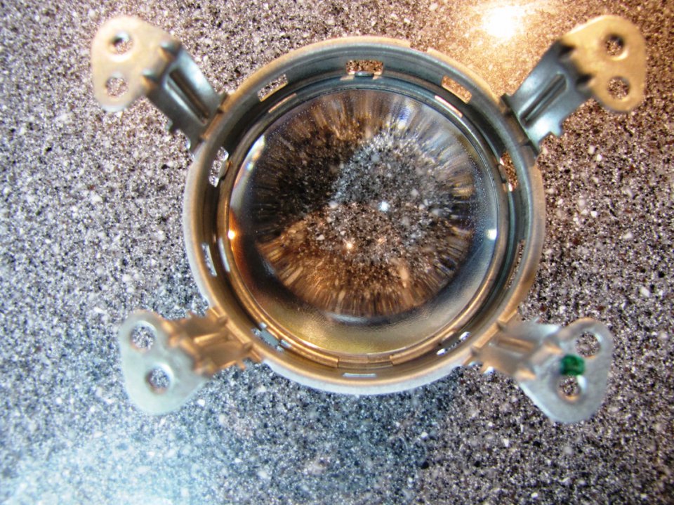

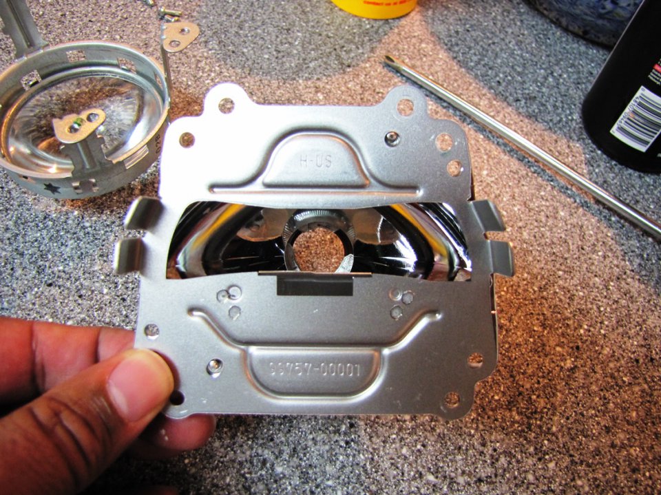

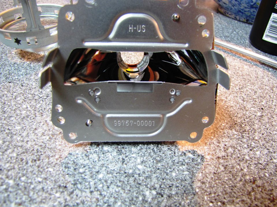

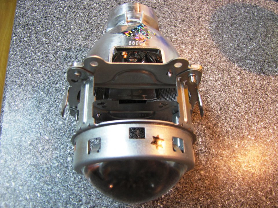

    Looking at the components on the RX350 and comparing them to your's of the stock Prius Is that dust on your lens of the Prius or slightly frosted like in photo #3 of the RX350?
    2010 RX Projectors (BiXenon) - Page 4
    I was trying to find photos of Halogen Prius projector on HID Planet but no luck. To my surprise(sarcasm), I did run across a lot of positive reviews from people who put in HID bulb kits in the Sienna and Prius. I would not be surprised if they share a lot of the same components or even the same/similar projectors?
    Would be awesome to be able swap the bi-xenon shields from the RX and put in the Prius!

    Wow.. getting close..
    "What projector is this and what bulbs it use? (SOLVED)
    EDIT: Solved. They are the halogen version of the popular Lexus RX-350 bi-xenon projectors, but came from the new Toyota Prius, and they are H11."​
  3. ataylor2
    ataylor2 Member
    May 30, 2013
    122
    East San Francisco Bay Area, CA
    I went back and looked, its dust. Not sure it would be worth it to swap just the shield. I mean by the time you find RX projectors to take the shield out of, you might as well just put in the Morimoto Mini projectors, I am sure it would be less. For $150 you can get them with the Prius mounting bracket that makes it a fairly easy install and I think that even includes bulbs.

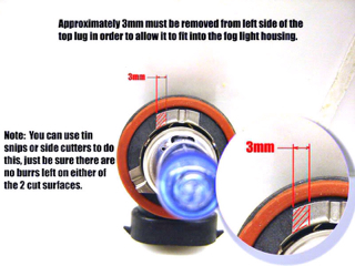

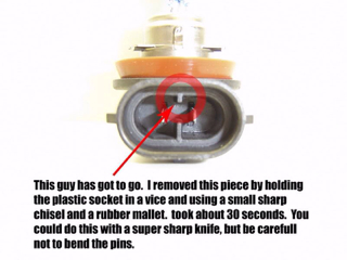

    I bought some generic H9 halogen bulbs of the 65w variety with clear capsules, not the blue colored ones. Shaved the extra tab in the bulb base and additionally, had to shave some of the metal tabs around the base down as well before they would fit into my Camry's H11 mounts.

    I had to shave the top lug and a little bit off one of the side tabs for the particular bulbs I was dealing with.
    Used a dremel type rotary tool with a grinding head, so it was really easy. Used the rotary tool with a small spiral cutter bit to remove the small plastic tab in the socket.
