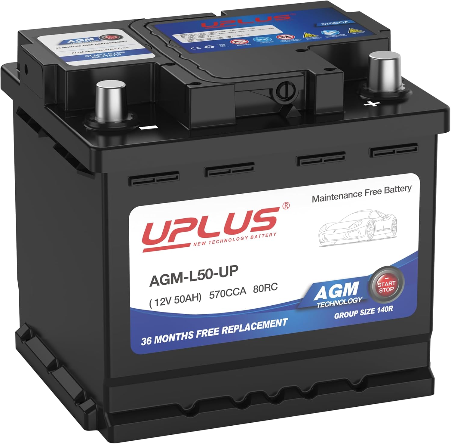

    The Turquoise Jewel's battery seems to be running at about 53% capacity (12.10 V open circuit) since the full drain in August. I don't know whether the full drain caused the capacity degradation or the capacity degradation caused the full drain in a month or less of idling. The car is a month short of four years since the manufacture now.
    I reduced the contestants to three:
    EverStart Maxx 140R standard flooded-cell (Walmart): $159.84 + $14.00 core − $14.00 core return
    ACDelco LN1 AGM (RockAuto): $135.79 + $12.00 core + $11.99 shipping − $6.79 coupon − $10 AutoZone gift card for core return
    Uplus LN1 AGM (Amazon): $132.99 + $0 core + $0 shipping − $10 AutoZone gift card for core return
    Uplus seems to be a really good company using the latest technology; so, I decided to go with Uplus. It was also by far the cheapest.
    I will update on how the Uplus LN1 AGM works on a Prius.
    Final thoughts: Flooded-cell batteries don't seem to work well on Priuses, and they seem to require AGM batteries. However, Toyota has downgraded to flooded-cell batteries in Gen 4/Gen 5 because they wanted to reduce the weight of the car by about 5 lb (AGM batteries are heavier) and reduce the cost of the car (by about $100?) Perhaps they will skip the AGM technology in Gen 6 and go with an LFP 12-V battery.

    Yes, and I looked at the plot you posted. It seems to charge at 13.4 V; so, it should be good to charge an AGM battery. So, the charging system and battery sensor do not seem to care whether is flooded-cell or AGM. In fact, AGM would probably work better than flooded-cell, as the internal resistance is lower, it charges faster with less energy loss, etc. I won't bother with a battery monitor, but I will measure the battery voltage to see if it stays charged at about 12.89 V open circuit, which is about 100% SOC for an AGM battery.
    I am guessing the only downside of an AGM battery will be that it is heavier by about 5 lb in this case.
    Incidentally, the battery measured 12.30 V open circuit today, which is 71% SOC. So, perhaps replacement is not needed much, but oh, well.

    The Uplus EN LN1/DIN H4/BCI 140R AGM battery I ordered from Amazon just shipped via FedEx from Azusa, LA County; so, I should receive it tomorrow. My OEM battery still has at least 70% capacity; so, hopefully I am not wasting my money.
