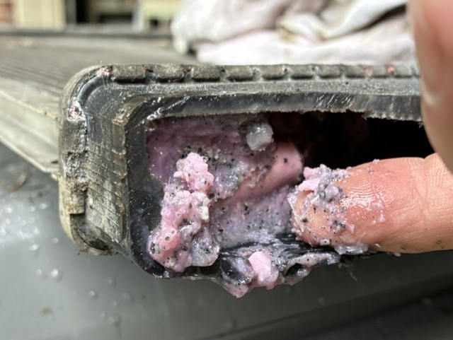

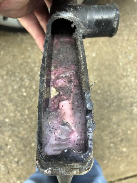

    My brother and I work on Gen 3 Priuses acquired from disenchanted owners. The seller of this one said the vehicle "runs just fine...no problems".
    Of course it rattled like a spray paint can with a blown head gasket, as most Gen 3's purchased from FB Marketplace do.
    Replaced the motor with a different one rebuilt by the esteemed Scotty Partin, a trained Toyota hybrid tech in Rockholds, KY.
    But after installing Scotty's rebuilt motor the vehicle still overheated on up-sloped highways, despite having a new thermostat and water pump in it.
    The problem was revealed to be the stop leak additive poured in the cooling system by vehicle's former owner. It plugged the bottom half of the radiator.
    My thanks to Scotty for his help on the project. He would not have known about the stop leak problem because he never saw the vehicle or its blown engine.
    Surprisingly the vehicle's heater still functions like a blast furnace, though I imagine that its water passages are pretty gunked up.

    Yeah that's very common it'll even INFlate up out filler neck . Really wild looking stuff usually. Pulling rad and presxur flushing all else . Sad

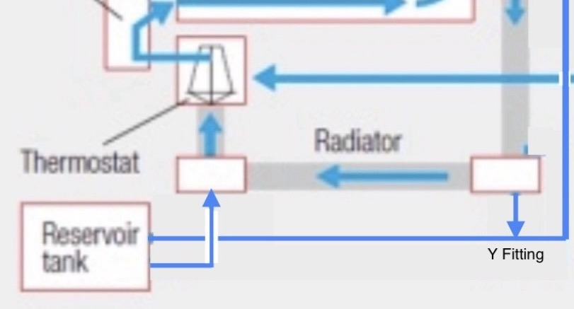

    It is very likely the flow into the reservoir tank will be higher when the radiator is partially clogged. This flow can be observed and could be measured.
    Radiator and reservoir flow starts when the thermostat opens. Before then, only flow through the thermostat bypass port to the engine occurs.
    The reservoir flow parallels the radiator but does not go through the cooling channels of the radiator.
    The flow restriction caused by the radiator micro channels creates pressure differential driving flow into and out of the reservoir.

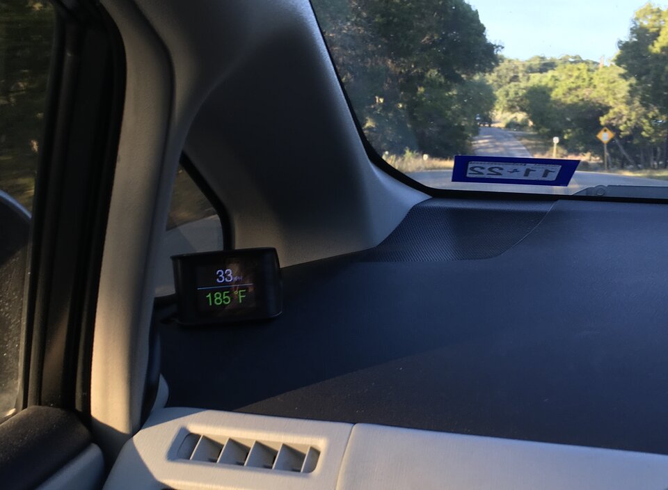

    Sometimes I think you just unblocked me
    $35 P10 with user set audible alarm on temp. Probably posted 15 times here.
    PrimeDan, xw20_driver and Brian1954 like this.

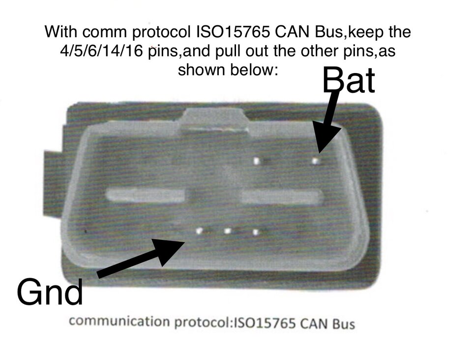

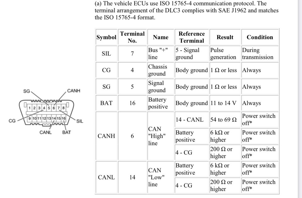

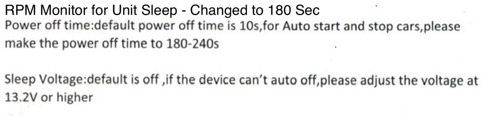

    I did a quick look of your past postings and can't find a build thread, any link to it? Does that hook into an OBD2? That's pretty cool. I'd like to do something similar myself with some other info as well if possible.
  16. rjparker
    rjparker Tu Humilde Sirviente
    Jun 6, 2008
    11,116
    6,975
    Texas Hill Country
    The P10 plugs into the obd2 connector which is constantly powered. So you set it up to sleep after 180 seconds of no rpm and reduced voltage.
    I use it to display coolant temperature which for a Prius is the standard block sensor. It is set for an early 220f audible alarm. I also set a 78 mph speed alarm.
    There are display options such as two or more parameters.
    See attached
