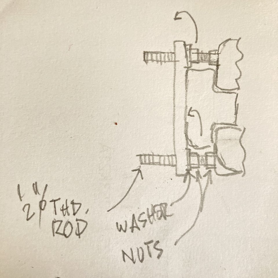

  13. Mendel Leisk
    60,080
    41,317
    That is poetry! (y)

  19. Mendel Leisk
    60,080
    41,317
    With third gen rears it's been suggested to put a largish (say 1/2" diameter) threaded rod through two of the bearing's front flange holes, and with some nuts and washers, jack the bearing out. You do run the risk of the bearing separating, leaving a race inside the bore. Something like this:
