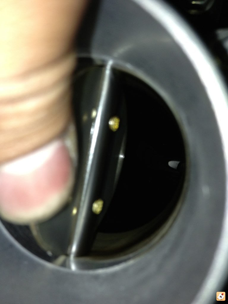

    FWIW, I took my intake apart and looked at the throttle body & clean it. First time I've seen a vertical throttle body - its basically mounted on the intake manifold and down low behind the radiator. At 59K miles, mine was pretty clean. I used a paper towel soaked in carb cleaner on a stick to reach in past the butterfly on both sides, and I didn't come out with much. There was some soot on the edges of the butterfly valve that wiped off easily. Beyond the butterfly valve was pretty dark.
    BTW, the butterfly can be opened by pushing on it, but there's a fair amount of resistance. Not like a conventional butterfly valve.

    There's a fair amount of resistance becasue there's a motor hooked to the right end. Open the butterfly by turning the spring on left side like every other tb. Don't push on the butterfly you'll bend the axle.

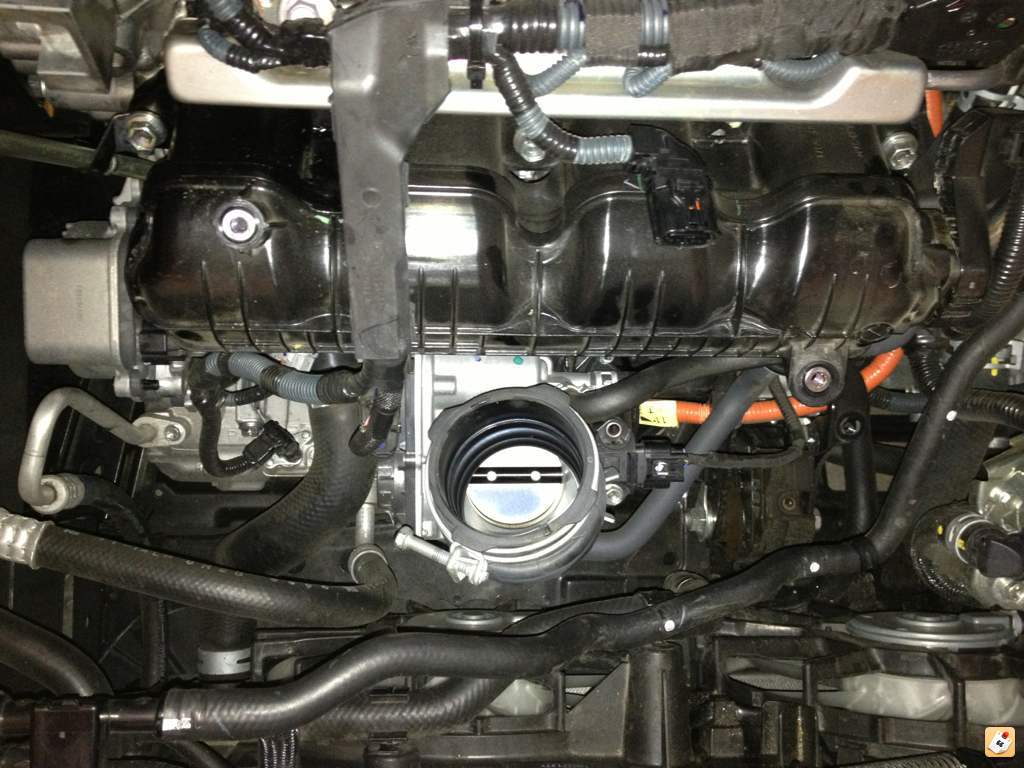

    I am not familiar with the Gen 2's throttle body, but I did the disassembly to check the throttle body on my Gen 3 and found both sides of the plate to be 100% spotless. This was around the 60k mark. Of course, your individual findings may vary.
    [​IMG][​IMG]

    Critic-
    Looks very clean but try just one of my old t shirt strips. You'll be surprised how dirty it is. Plus make sure you hose out the pvc pipe the pvc hose is hooked to. Thats where alot of the gunk is out of sight.
    Boochi101-
    Yes my strip method captures all the contaminates and removes them as opposed to just flushing it out where it goes down the intake and is burned off by the cylinders. That's alot of carb cleaner and dirt into the cylinders hence the rough running you experienced. Not good for the cylinder's. If your really unlucky it can backfire and damage the valves or rings.
    The one bolt that's hard is in the photo provided by Critic which is the bolt and clamp under the air cleaner box that holds the throat of the box onto the throttle body. Its important that clamp is on right or you will have an air leak post maf which will put the engine into a tizzy.
