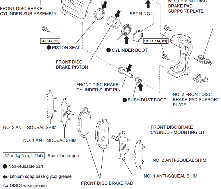

    Second gen Repair Manual excerpts attached:

    No listing of an individual's "go-to lubes" would be complete without disclosing that Toyota specifies greases for these applications.
    For the spots with the hollow arrows here, the specified grease is an opaque gray stuff that is silicone-based, probably similar to a lot of disc brake greases you can find elsewhere.
    For the spots with the solid black arrows here, the specified grease is a clearish red stuff that is not silicone-based; it is glycol-based with a lithium soap thickener, 08887-01206 as seen in the tube at the top of the photo below. So it is not very much like Sil-Glyde or similar products.
    It's often unnecessary to buy tubes of the stuff; if you buy shim kits from Toyota, a little packet of the gray shim grease will be included, and if you buy the rebuilding rubber kits, a little packet of the red glycol grease will be inside.
    I do not claim there aren't people who substitute other grease formulations and maybe get away with it and are perfectly happy. It's just irresponsible to post about those substitutions and not be clear that they are substitutions and are different from what is specified.
