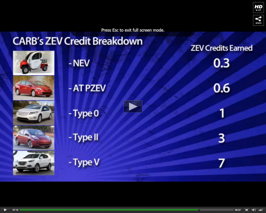

  13. Troy Heagy
    Troy Heagy Member
    Apr 21, 2013
    1,218
    WHY car companies are pushing hydrogen cars (source: Autoline Daily). Basically..... they get upto 3 times more credits for a hydrogen car (as high as nine) than they get for an electric car (3).
    So the EV is out of fashion (dare I say: obsolete?) due to government interference in the market making them unattractive. Plugin hybrids with partial EV capability are also being hurt:
