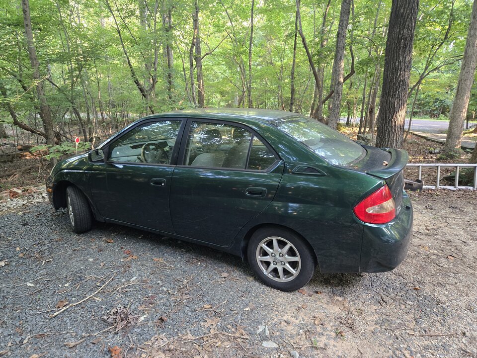

    It seems there have been several threads like this lately, but ah well. Some of you may have seen my last thread about an intermittent issue I was having with my good ol' first gen. I *think* I have narrowed it down to the fuel pump or fuel filter, neither of which is really practical for me to deal with at the moment. I now fall on the other side of the "who should and should not own a 1st Gen" equation. I'm in a supervisory position at work and need a 100% reliable vehicle, so I bought a new(ish) hybrid with a warranty that was a good deal.
    The Prius still runs and drives fine aside from that occasional stall/restart (fixable, just not worth it for me). So now my conundrum is that I don't want to keep paying insurance to keep it on the road, but also don't want to scrap it. The hybrid battery was replaced and is in great condition, and the ICE/inverter/transmission/etc are all in good shape. Swapped the fluids and cleaned the transmission pan like a year ago. Heck even the AC blows ice cold. I've been driving it to and from work the way it is for months, and there's a good chance it could make a longer trip although I don't know if that would be a great idea.
    Does anybody have a good idea for an interesting project I could do with it when I have the spare time/vacation (maybe turn the components into a generator, or hack it into a pure EV for my nephew when he's old enough to drive in a few years?) Or is somebody in desperate need of a parts/donor vehicle for a component that is tough to find? 1stGen.jpg
