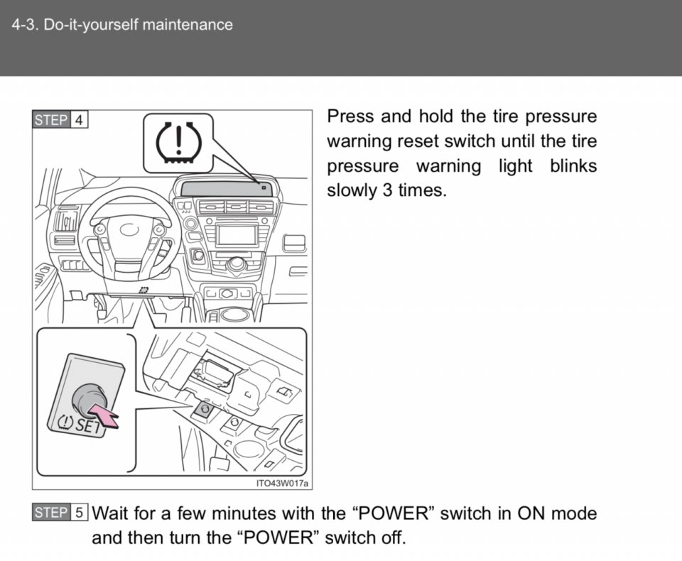

    The manual does call it a Reset which adjusts the monitored pressures - but it does not clear a blinking error. A blinking tpms light at startup indicates at least one sensor is not detected, generally caused by a bad sensor battery.
    Replacing a sensor requires writing the new sensor's unique serial number into the system, typically with Techstream or a dedicated TPMS handheld device using the OBD2 port.
    Aftermarket sensors will work. I recently replaced mine for $36 plus installation at a tire shop.

    From the owners manual
  15. ChapmanF
    28,758
    19,086
    Well, yeah, the English translated text next to the picture says to "press and hold the ... reset switch", while the switch itself is labeled SET, which is a better fit for what it does.
    The point is for people to know that what it does is set the tire pressures you want. A lot of people, when they see the word 'reset', assume it does more than that, and start trying to solve problems with it.
    The problem you can solve with it is when the tire pressures you want are different from the ones it's set for. :)
    Air_Boss likes this.
