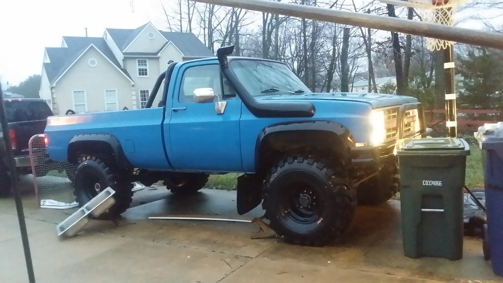

    LOL... ummm its a prius.. im going so slow it dont matter!!!!!!
    and fyi.. for snow ill take this out...
    [​IMG]20160314_191200 by Jeffrey Riggs, on Flickr

    yeah so when people make fun of me for driving a prius then later they see me driving the truck.. they are like woah...
    full 1 tons, 4:56's, 40's, detroit lockers !!!!! hoping in march/april to get rid of the sb350 and go BB 496 (8.1L)!!!!
    oh wait.. back to prius forums...
    [/hijack] :ROFLMAO:
