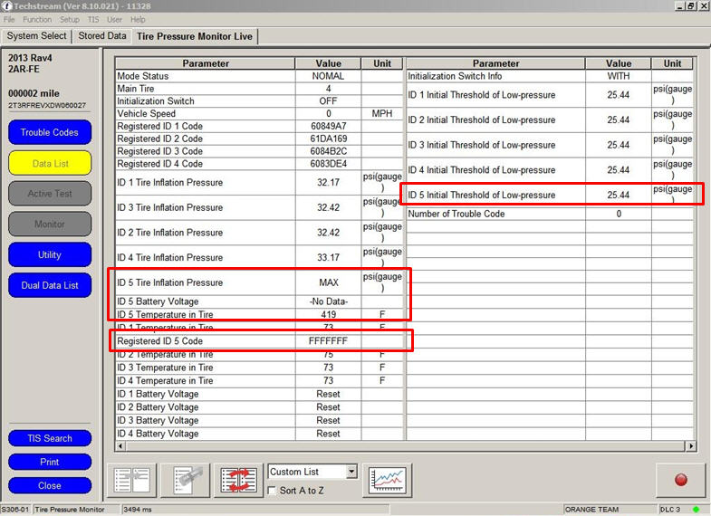

    Normally what is done is a computer is used to communicate with the Prius. In doing so, it registers the code found on each sensor within the tire. Anytime a sensor goes bad and needs to be replaced, the codes in the Prius have to be adjusted for the system to work properly.

    This will make the light bulb turn on "ahmeow" Look at the following picture. Notice the "Registered ID Code's" That is the codes that are registered on that vehicle at the time "Techstream" viewed the system. The codes are found on the each sensor and are registered with software and a computer or hand held OBD device that can communicate with the TPMS on the vehicle.
