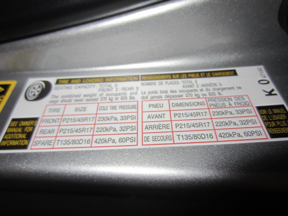

    Really? the pressure is lower? Can anyone that bought a 3rd gen Prius that had 17" stock rims confirm what the pressure is written on the door panel?
    Edit: I forgot I have the owners manual in pdf...
    Tire size P215/45R17 87V
    Front tire:
    33 psi (230 kPa, 2.3 kgf/cm 2 or bar)
    Rear tire:
    32 psi (220 kPa, 2.2 kgf/cm 2 or bar)
    Wheel size 17 × 7J
    Wheel nut torque 76 ft•lbf (103 N•m, 10.5 kgf•m)
    Tire size P195/65R15 89S
    Front tire:
    35 psi (240 kPa, 2.4 kgf/cm 2 or bar)
    Rear tire:
    Wheel size 15 × 6J

    Here's the spec plate for my prius. Hope that helps. I know a lot of owners in this forum are running 40 psi or more. I would not go that high personally just because i have a bad back.
