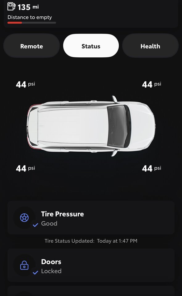

    I’m back asking about tire pressure. My 19” tires were delivered with 40 psi. On cooler days the psi dropped to 37-38. After my last visit to the dealership they put the tires to 40 again. Today it’s in the 80’s and during my 20 min drive the psi reached 44. This is obviously too high especially when temps are going to increase.
    Priorities:
    Avoid pinch flats/damaged wheels
    Avoid premature suspension wear
    Why does the manual say add 3 psi when driving speeds above 100 mph?
    At this point I have no way of adjusting pressure when tires are cold and I have no idea how much the pressure will increase on high 90 degree days. I can’t imagine putting rear tires down to the recommended 33 psi.
    Does anyone who has 19” tires have experience with these fluctuations and have recommendations? Thanks

    IMHO; don't worry about it - the temperature fluctuations are baked into the 'measure tire pressures when cold'. You need to be concerned about the Max. tire pressure when cold, stamped on the side of the tire. So if the tire is at or near max pressure when cold; you can only imagine what the pressure would be on a hot day, on hot black-top pavement, and getting hotter on the highway.

    Old rule of thumb was for every 10 degrees change in temperature(F), the tire pressure changed 1 psi. The pressure of a tire filled at 70F will go up about 2 psi at 90F. As long as the tire pressure when cold is below the max, you shouldn't worry about the increase from being driven.
    The higher pressure at high speeds is to increase the sidewall stiffness. This provides better performance in turns. It also counters the heat build up from driving at those speeds. The friction between road tire isn't the only source of heat to the tires. The other is in the side wall flex that takes place at the contact patch spot of the tire. Bend a paperclip back and forth and it heats up at the bend spot. The same thing is happening in the tire rubber.
    That heat generation why an underinflated tire is more likely the blow out than an overinflated one. More flex equals more heat. We have TPMS now because people let their tires get too low. Stiff sidewalls also improve rolling resistance, and might help avoid pinch flats.

    That would be a good screen to look at with your morning coffee.;) That'll give you a better idea of how far off you are from OEM recommendations. Bear in mind that if you take them down to OEM recommended pressures, you may trip the TPMS system, if it was calibrated to those higher pressures and you may have to pump more air into them come fall and winter months.
    Good Luck.

    What does the decal in driver’s door jamb say, 33/32 psi f/r? I would at least give that a try. The TPMS is likely set with those pressures, at the factory, then tire pressures raised for shipping.
