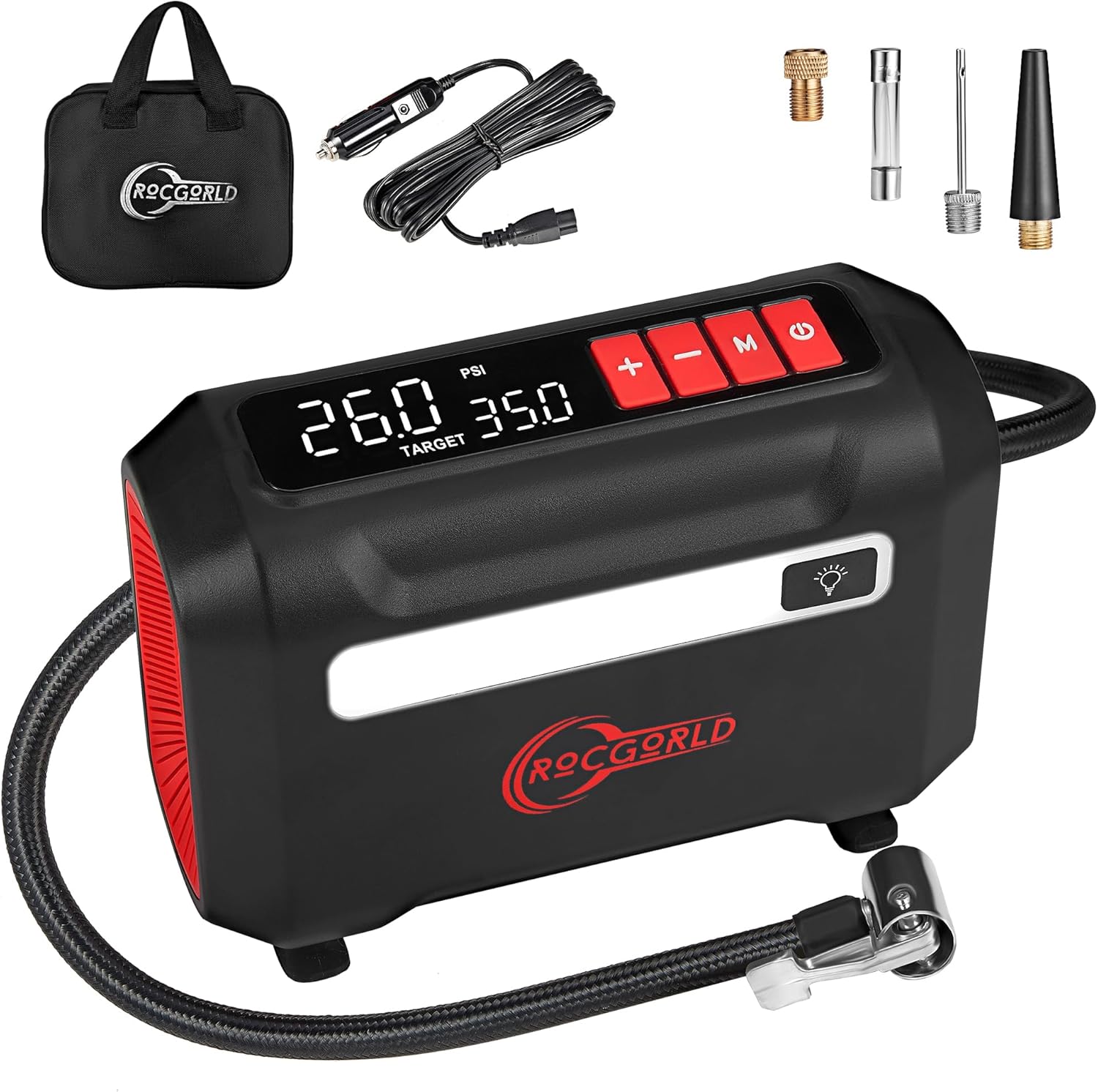

    Also, get a digital air compressor from Amazon and carry it in your trunk at all times. You will never need a tire-pressure gauge and gas-station compressors or bicycle pumps.

    There doesn't appear to be a screen/display anywhere on my U.S. 2024 Prime XSE that I can access to display the tire pressures. I believe I have scrolled and looked at them all. Others on this forum have said the same thing. Maybe other models/years/countries do but not this one.
    By the way, which model digital air compressor is recommended to carry and use?
    KH
    Gokhan likes this.

    I don't know about 'recommended', but I use the Slime 40051. It's already come in handy for me twice in the last 10 months with slow leaks - top off the air when the TPMS goes off, until I can get somewhere to get tire repaired.

    I am very happy with this digital air compressor I bought on Amazon. It is very loud though (I am guessing like most), and you might benefit from ear plugs.
    RoCGoRLD R8 digital air compressor on Amazon
