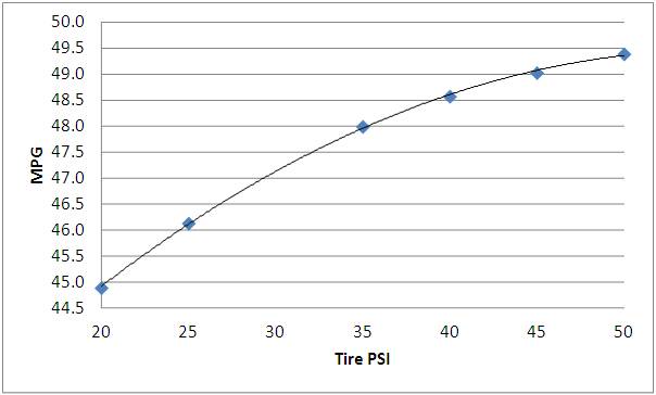

    Oh for Pete's sake you just want to see if I can find my previously posted graph.
    This is generic, using some rolling resistance equations given in a prior thread.
    Focus on the shape of the curve, the MPG drop off is 2x as bad under 35 psi.
    Unrelated to psig, keep in mind rolling resistance is higher when tire is colder.
    Takes the tires about 20-minutes to warm up.

    Nice graph!
    Thanks for sharing!
