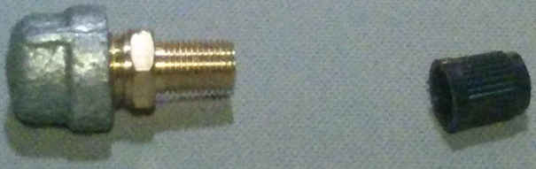

    And so it does. I went over a thing on my way out of Yellowstone (I think the thing was a rock chunk dropped from the rock face alongside the road) and on came the tire-pressure light.
    There was a nice flat paved turnout just beyond, so I had a fine place to get out my plug kit, jack up the car, take off the wheel, and see the damage was in the sidewall where I couldn't use the plug kit.
    So on went the spare, which was conveniently at 60 PSI already, but of course a couple pounds get lost in the process of unscrewing the blue hose. So once the spare was mounted, I was able to cap the blue hose with the above and then use the on-board air to top up those lost couple pounds in the spare. The behavior without a spare as the 'tank' wasn't pretty—fast cycling, along with some exercise of the relief valve—but it was usable.
