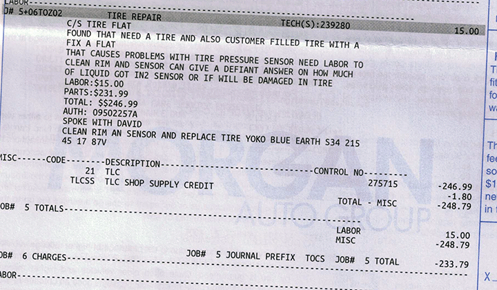

    My Prius IV Touring came with the Toyota Prius Tire Repair Kit (goop and inflator). I never trusted it, so I bought my own full-sized spare. Recently a nail punctured my tire. I pulled over, and was about to swap on the spare, but I thought I'd test how well the repair kit works.
    I followed the instructions, and all that happened was the tire goop sputtered out of the hole, never sealed it, and never inflated it. I added my spare, and went to the dealer where my car's tires are covered with a road hazard protection plan. I explain that I first used the Tire Repair Kit and it didn't work.
    It takes the dealer 1.5 hours to diagnose that they cannot patch the tire. They don't have that specific brand in stock, but they do have one in another brand that would fit. I ask if that is a low-rolling-resistance tire, and the service adviser wasn't initially sure what that meant. After some checking, she said that it is not, but she can order the matching tire and it will arrive within a week. I agree, and drive around on my full size spare for the 5 days it takes to get my new tire in.
    It takes the dealer 2.5 hours to put on the new tire and perform the 15,000 mile service. When I get my car, my receipt details the jobs performed (see attached). I'd like your opinion. It seems like they are blaming the customer (me) for using Fix-A-Flat -- like they are suggesting that I shouldn't have done that. I didn't use Fix-A-Flat, I used the system provided by Toyota. I'm not sure what they mean by "can give a defiant answer about how much liquid got in sensor". I never had any such conversation with the service adviser.
    Am I over thinking it? Should I call the service manager and get clarification as to what they are talking about? Are they overtly blaming me for doing the wrong thing? Is using the official tire repair kit bad, overall? Should I just go to a different dealer for future service?
    Thanks :)
  2. Mendel Leisk
    61,557
    42,355
    Do all those minus signs mean no charge?
    Anyway, I think your first mistake was not following through, just installing the spare. Even if the goop had worked, it leaves a big mess.
    And yeah they're off base with the fix-a-flat comment.

    3 hours of labor to change 1 tire? That's just a paperwork number, the technician did not spend that amount of time. Don't pay a cent to that dealer unless its free under warranty.

    It's free for me under the dealer's road hazard insurance. I wouldn't have paid $300 for a tire.
    It occurred to me that the description is a fluff number to get more money out of the tire insurance company for the job -- perhaps the insurance company was defiant about the amount of labor or fix-a-flat. IDK.

    The "covered with a road hazard protection plan" - have you read the terms and conditions? Maybe it excludes "goop" repairs.
    I believe tyre shops charge extra to clean a rim which is covered by GOOP - but might depend on the shop.
    I'd read about "issues" with GOOP - when I bought my FIESTA in 2011 I complained vigorously that I had to pay $300 for a wheelbarrow tyre as it only had goop supplied. In that case, there was a jack and wheelbrace supplied - but some cars don't even get them. I noted that 6 months later, a wheelbarrow tyre was supplied FREE with FIESTA. UGGGH. GRRRR.
    Yes, the tyre repair companies hate the GOOP - one told me that it 1) often means the tyre can't be repaired anyway - but could have been if the GOOP hadn't been used; 2) cleaning up the rim is an EXTRA COST; 3) you can't just leave the spare to get fixed and come back - you have to wait in line till they can fit it in; 4) - I've forgotten, let me know if you remember what I was going to say.
    TOYOTA UK BLOG - check out the comments below - nobody likes them!!!!

    So, maybe the tire repair kit is a scam to upsell tire/cleaning services that could have been avoided with a $10 patch? Hmm...
    I was mostly unnerved by the tone of the shop's writeup.

    Wait, looks like labor was only $15 and the bulk of the repair ($246.99) was for Tender Loving Care (TLC)? ;)

    toyotas fix a flat system destroys the sensor, from what i've read

    The more I read, the less I like it - there are 4 pages of warnings - (2 more than I've pasted below) - the number of times "spattering" or "stain" - plus the health warnings (though I'm not sure why/how one would ingest it). It says to leave the nail/screw in place, and also to pump it up twice, the 2nd time after a short drive.
    [Off Topic - but I just read in Popular Science (Aust edition - the final one) that the toxic dose of ingesting dark chocolate is: (2 figures are male/female)
    upload_2019-3-6_11-45-43.png - my mind immediately thought - who ever tried this out without getting quite ill first?]
    BUT - it doesn't mention the Tyre Pressure Monitoring being destroyed - but the tyre valve will be.

    I noticed it says "defiant" but think he misspelled definate.
    If they were turning it into Toyota to get paid they wrote it up so they can get reimbursed, my guess.
