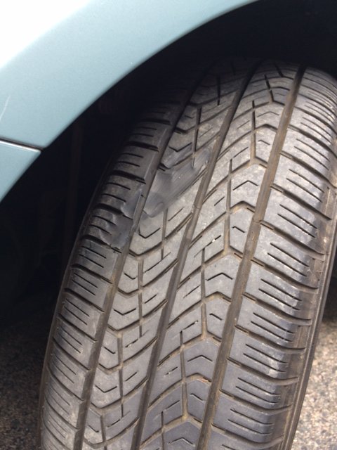

    I took my 2012 PiP to an automatic carwash, the kind that pulls you through, and it emerged with the tread damage shown to the left front tire in the attached photo. I know, lots of reasons not to go to those kinds of car washes. Now I know why they have signs disclaiming liability for damages. . .
    The missing chunk of tread doesn't expose any of the belt or structural elements of the tire, and doesn't extend below the deepest grooves that go around the circumference of the tire. The tire only has about 6K miles on it, due to a nail puncture near the sidewall of its predecessor last Sept. Still, I'd rather be safe than sorry.
    Any opinions about whether this merits a new tire?
    Thanks in advance,
    Dan

    Ker CHUNK!!! What in the world would have done that??? Was that on the type of car wash that pulls the entire car through it? I would take it back and ask them to replace it, regardless of their "stated no liability" as you really can not legally do that. I had an old Pinto that the overhead rolling brush caught the antenna, and it tried to pick the car up with the ant. when it got caught. They still paid to have it replaced regardless of all their signs saying they held no responsibility for damages. Just tell them you will take them to small claims if you have to, and see what they say. I would not feel totally safe with that tire on a real wet road... Ker Thunk, Ker thunk....

    i think i would replace it. can you be sure it happened in the car wash? i don't see how a tire free wheeling through could undergo any kind of damage like that. but i'm not sure what else could have caused it either, it looks very strange.(n)

    My $.02 is to not trust that tire anymore and have it replaced. True that the gouge did not reach down to the belts, but I am imagining the force involve to make such a gouge, and I think it could weaken the carcass in that area such that you will ultimately have a carcass failure and either separation of tread from the steel belts or a blow out.
    If you choose to keep tire, please consider re-balancing it as you lost a few ounces of rubber from that spot. I would expect the tire to "thump" when that low spot hits the ground, and that would bother me just as flat-spotted tires bother me.

    Thanks, everyone. Replacement it is.
    Interestingly, the tire doesn't seem to make any distinctive noise, but I've only taken it up to ~45 mph. The car was off, in neutral, as it went through the wash, but it lurched and moved slightly laterally when the puller started, so I suspect I wasn't lined up correctly, despite the thumbs up from the operator.

    Looks like it hit the guide, like you described, in your post. I would bet that if you were to go back to the carwash and look at the metal guide tubes/pipes on the left side of the carwash entrance, there is a missing cap or open end that took a scoop of tread out of your tire when it was pulled into the guide rail.

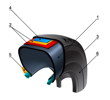

    No, the damage is in the tread and not the carcass. Those are 2 separate things molded together. This should not be safety issue, but I can see how there could be vibration or uneven wear at that spot.
    Carcass is #1, under the belts.
