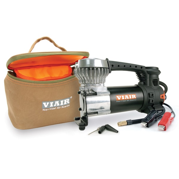

    Still waiting on my Prime to be built, BUT after reading all the issues that the flat fix goo causes, I ordered a Viair 87P portable compressor ($40) and a Boulder Tools heavy duty Tire Repair kit ($34) to dedicate permanently to the Prime. The Viair 87P is only 4.30 lbs and 9.1″L x 3.1″W x 5.6″H with its own carry bag. It runs directly from the 12v battery so amps draw on a cigarette outlet are not an issue. (for a small car tire, it does not need to be a large capacity 100% duty cycle $$$ compressor) I suspect it will exactly fit where the Toyota Prime flat kit fits, but I've not tested it yet. (no vehicle yet)
    I already have and have used a Safety Seal flat kit about 20 times over the years and will keep it for offroad adventures in my 4runner. For the same or less money, the Boulder Tools Heavy Duty Tire Repair kit is nicer and has more tools (pliers and knife) so you don't need to carry a separate (heavy) tool box. All metal handles are also a plus. No plastic here.
    I've had 4 screws on 4 different occasions on three of my vehicles in the last 6 weeks. Each time on a rear tire. One went through the middle of a very thick 3/4" lug of my BFG AT K/O's on my 4Runner so the car tires never had a chance in comparison. I fixed each one with the plug repair kit. No issues, it just works and is permanent and comes with 30 uses and you get extra plugs. They do not dry out. My original kit was purchased in 2000 and the plugs are still perfect.
    Even if you use the supplied Toyota compressor and goo, you have to find a replacement goo canister to use again and people have reported trouble finding them. So that makes it a one use item. What if you have two flats? The goo has the reported potential to mess up your TPMS sensor and valve stem so that's extra expense plus the goo inside the tire has to be removed later.

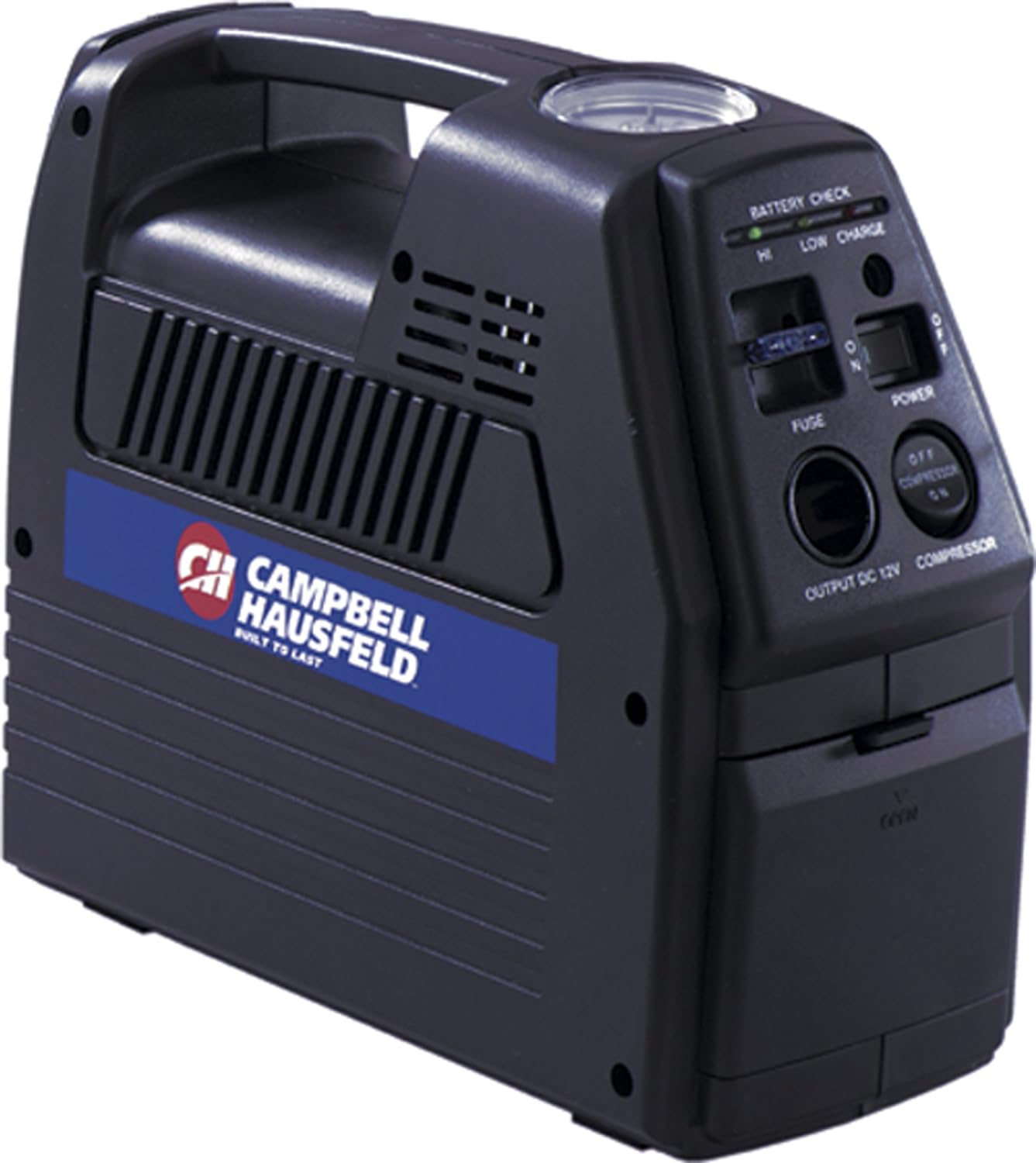

    this one's better because it has it's own rechargeable battery

    You are certainly welcome to your opinion. I owned and 'threw away" one of those. Point is, it something different and separate from the included Toyota flat solution that does not make you worse off than before the flat.

    agreed, of course you have to babysit the one with an internal battery every six months or it becomes useless. yours on the other hand has a battery that's charged every time you run the car. ( or at the very least charge the EV battery)

    And don't ever let the Campbell version get below freezing or you'll be tossing it. That's one reason I could never put it in the vehicle and leave it and/or rely on it.

    Or in a hot car, yup, read the directions, I only store it in my car if I'm going on a long trip, otherwise I depend on the SOS function of my Prime Advanced model.:D

    Coincidentally, mine just arrive today. I put the loaf of bread next to it to give it some scale. 10ft power cord and 8 ft air hose. It's long enough to reach from the Prime battery location back to the opposite rear tire.

    I have been using the Viair 85P which has the cigarette lighter plug for the last 3 or 4 years. I used it with my 2012 Prius IV and now with my Prime and have never had it blow the fuse on the car. Even though the instructions say to "have the engine running", I usually use it in accessory mode when adjusting tire pressures - never had a problem with exhausting the tiny battery the 2012 Prius has. With the Prime, I probably will put the car in Ready mode in the future since the engine doesn't start.
    I have even used it with a 4 Amp Hr 12V battery that I used to use for a model airplane engine starter. After adjusting all four tires, still plenty of power left.

    That's great to hear. Each one of these models pulls a different amount of amps based on ability so I decided to just avoid the cigarette lighter mode all together. It just made it one less thing to worry about. Now that the Prime's 12v battery is under the hood, it's much easier to access.
