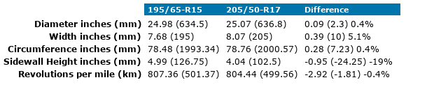

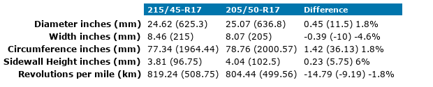

    According to this calculations you will have slightly differences in minus.
    And in speed will be some differences:
    FuelMiser and Mendel Leisk like this.

    Thanks. In my case the original tires were 195/65/15 for 25" diameter. The 205/50/17 is 25.1" on paper. Closer than the 215/45/17 at 24.6".

    Interesting that that's a link. Here's 15" stock comparison too:
    One issue with 205/50: seems like they're always Extra Load (XL)?
