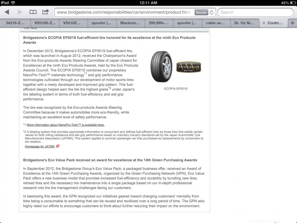

    I wish Bridgestone would release these tires for the USA before summer I need new summer tires and we liked the ep100 and they
    discontinued them.
