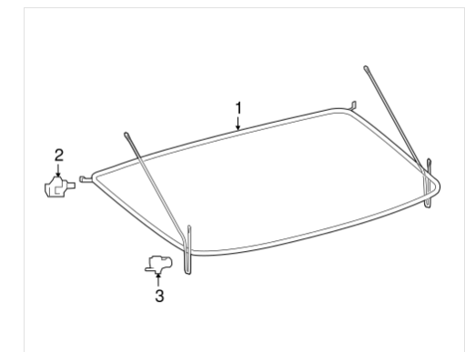

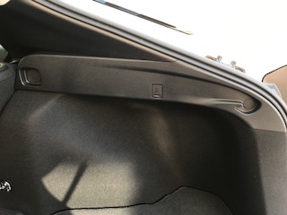

    i have a 2017 eco and no Tonneau cover. I want one, but not going to pay for the $550 one, so the flimsy one will do. However, i dont have any mounting brackets at all. is what you are describing in the holes in the side molding part #s 2 and 3 on this product picture:
    I want to buy the cover but want to make sure i buy any necessary pieces with it. see my picture of the cutouts i have.
    I also have no "hooks" to attach the ropes to the truck so that it raises when i open it. That i think can be fixed by me manually attaching some type of hooks with glue or something, but i am more concerned about buying the right parts to fit into the holes of this side inside of the trunk [​IMG]

    please someone take a picture of the attachment points and the little hooks on the lift gate (trust me, i dont have any hooks on my lift gate- yes, crazy toyota would make 2 separate molds to remove such tiny hooks- but i think i can easily create some just want to see where they are located and what they look like)

    For those interested in the lightweight tonneau cover, called the Type B luggage cover in the Owner’s Manual, it seems from my research that the following parts would be needed for a complete installation, with hooks at three points on each side. As shown in Figure 64-04, Deck Board & Deck Trim Cover:
    • COVER ASSEMBLY, TONNEAU, 64910-47070 (Quantity 1) (List Price $108.58)
    • HOOK, ROPE. BLACK, 66311-47030-C0 (Quantity 2) (List Price $13.96)
    • HOOK, ROPE, NO. 2. BLACK, 66312-47010-C0 (Quantity 2) (List Price $2.33)
    If the existing left and right back door side garnishes do not have hooks, they must also be replaced. As shown in Figure 67-08, Back Door Panel & Glass:
    • GARNISH, BACK DOOR SIDE, RH, 67937-47070-C0 (Quantity 1) (List Price $55.88)
    • GARNISH, BACK DOOR SIDE, LH, 67938-47070-C0 (Quantity 1) (List Price $55.88)
    Unlike the rolling (Type A) tonneau cover kindly mentioned by @Tbloemer, none of these parts is used on Prius cars sold in Japan, so IMPEX JAPAN or other exporters probably won’t have them. Many dealers in the U.S. sell them online at a discount, however.
    When replacing the garnishes, the back door trim upper trim panel assembly is removed temporarily; see the Repair Manual (available by subscription to techinfo.toyota.com) for the procedure. The garnishes and trim panel assembly are held in place with clips, 90467-10161, list price $1.26, which are replaced only if broken.
