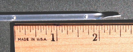

    <div class='quotetop'>QUOTE(jayman\";p=\"63690)</div>
    I played a role in drawing attention to overfill in a Prius. But that had nothing to do with engine damage. It was purely a matter MPG influence. I was ticked off after discovering how much extra oil the dealer had put in. So I drained the excess and then some out, bringing the dipstick level from 3/8" beyond full to 1/4" below it. That resulted in a immediate MPG improvement.
    Then people began to chime in about how the sludge problem from days past with traditional engines were in part related to overfill too... hence the amplified attention and the concern about engine damage.
    Then I made it worse by publishing that oil-change document, which there has been well over 10,000 downloads of now.
    The snowball-effect is pretty amazing.

    John would you do me a favour and measure the distance from the stopper at the top of the dipstick to the full line and either PM me or post it here. I'm wondering if there is a variable in the marking of the dipstick. Thanks

    just check both of ours and the measurements are
    2k3) 14 5/8" 372MM
    2k4) 14 9/16" 370MM
    I'll do some more tests at work and see if there is a variable in the dipsticks. Both our cars were 1/8" over when we got them. 3/8" is probably not a good thing.

    From the base of the handle (the plastic part that makes direct contact with the engine itself to stop the disptick from going any further in) to top of the full mark is the same as yours: 14 9/16"

    John, forgive me for asking but I'm not sure how I relate the picture to the measurements you gave. :roll:

    I report 371 mm from the "fingerloop stop" to the center of the "full dimple" on 2001 Prius.
